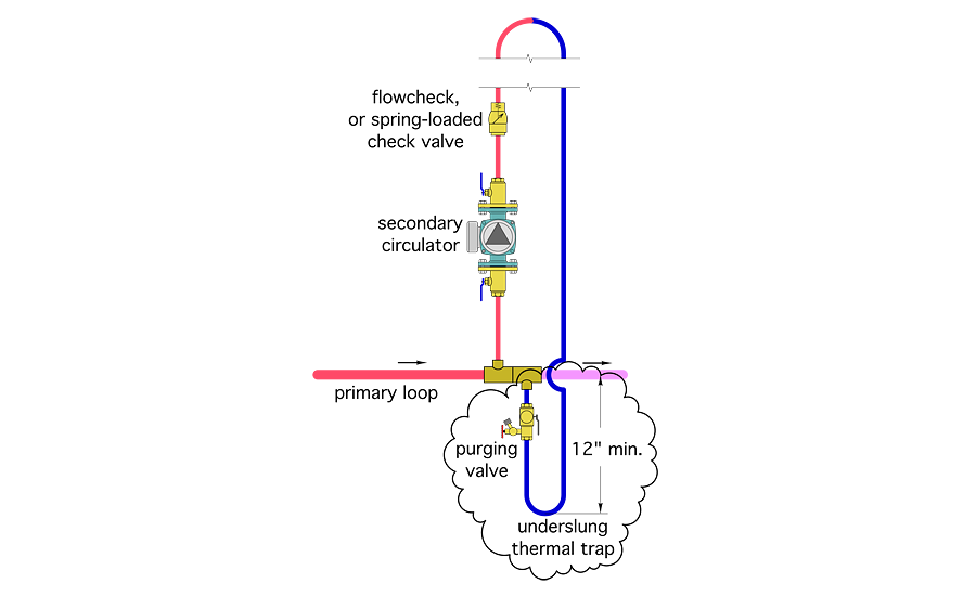

BTW: The pumps all seem to be oriented pumping toward the return side of the boiler. If it's a failed or absent check valve the pipe directly above the red pump would start to noticeably rise in temperature when either of the other pumps started running. If there is a lot of crud built up in the system a piece of grit could be keeping the valve from closing completely. Grundfos pump-integrated replacement check valves are pretty cheap ($30 from Home Depot), so if the symptom looks like a leaking or absent check valve on that pump it's worth having one on hand and seeing if installing/replacing the check valve fixes it before investing a zone valves. Zone valves aren't cheap, and they too can be kept open by crud in the system. It may be worth installing a crud trap /filter on this system.
If the problem turns out to be forward convection due to the return side being tall and much colder than the supply side that's more powerful than the spring in the pump-integrated check valve that may be stopped by plumbing in a big U that drops at least a foot below the return manifold (or in your case, the pump) before connecting to the manifold (or pump.)
This diagram shows the pump on the supply side of the circuit in a primary/secondary plumbed system, but it's not any different if the pump is on the return. The deeper the U, the more effective it is.
Yes the pumps are oriented to pump towards the return side. YES!!! The pipes directly above the pumps all get HOT when when one zone is on and the others are off. When I bled the system there was A LOT of brown/black water and sediment coming out. Since the previous home owner told me that he has never noticed the baseboards being hot when the thermostats were off, hopefully its safe to say that I clogged the valve when I bled the system.
How do I go about cleaning out the pump? Does it have to be removed and disassembled?
Great Idea. Any recommendations on brand/type and where is the ideal location to install it?
This could be a cheaper option then installing 3 zone valves. However, if my problem is a clogged check valve, then perhaphs this method or the zone valves are not even needed?
