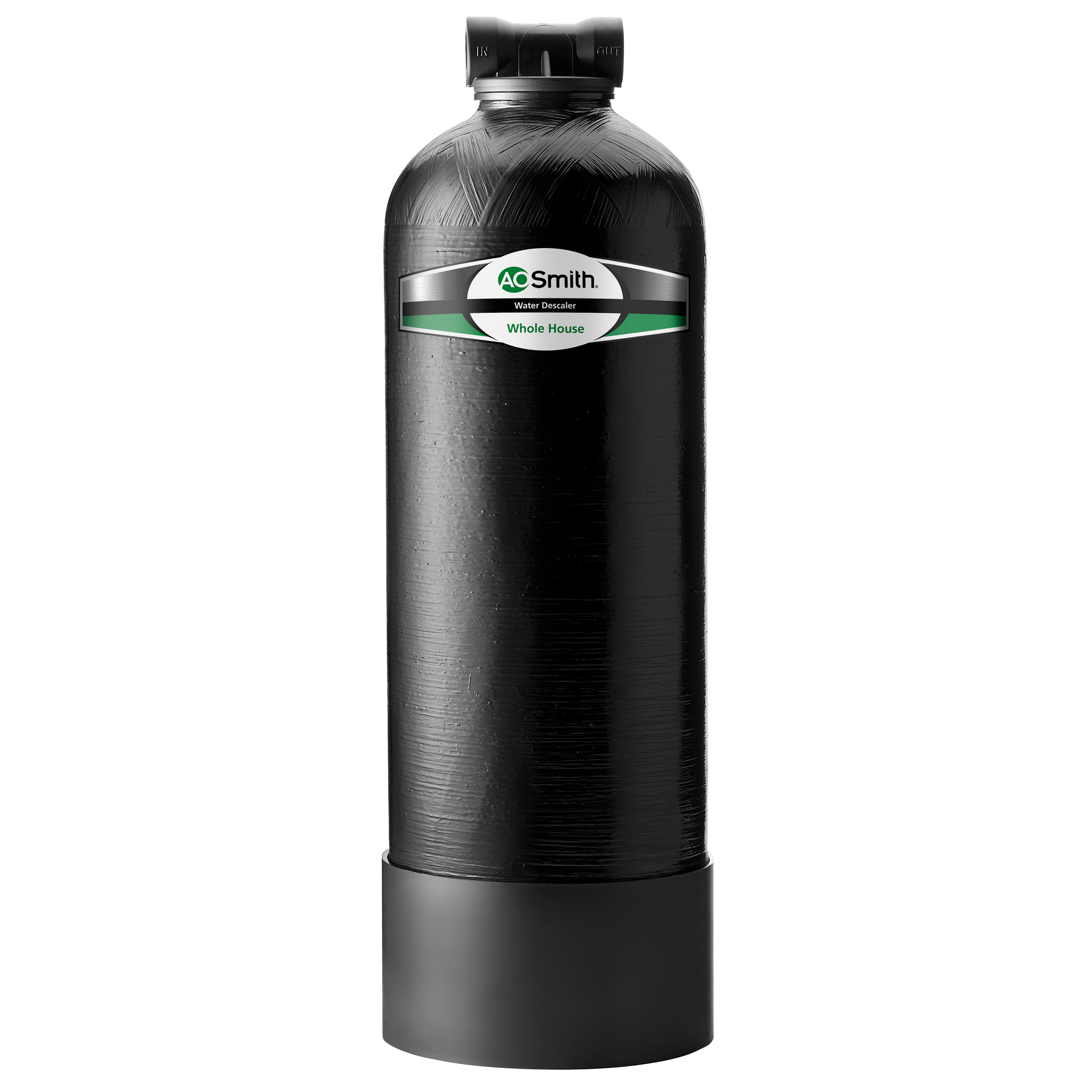

I saw that AO Smith has partnered with Lowes and will start selling softeners and other water treatment devices at Lowes. I checked out their site and saw two products, a softener:
https://www.aosmithatlowes.com/products/water-softeners/ao-wh-soft-400t/
and a salt-free descaler/softener:
https://www.aosmithatlowes.com/products/water-filters/whole-home/ao-wh-dsclr/
Does anyone have any insight into these products? I have had good luck with AO Smith water heaters, but didn't know they made softeners.

LOL, 8 gpm Service flow rate at 15 PSI drop. Good luck with that one. Looks like another "Lowest Bidder" unit that looks pretty.
Salt free softener... nice try. It is a scale reduction unit... we manufacture thousands of these, their performance is nothing like a softener. Most people honestly cant even tell if they are installed or not.

That is probably the magic media that anti-scale systems use. It is basically an anion resin that has been modified. That stuff is the most expensive media we stock, and does it work? I am still waiting for someone to show me a way to test the water after it goes through the media. I have seen it have some affect in some applications but not consistently enough to actively push it.
