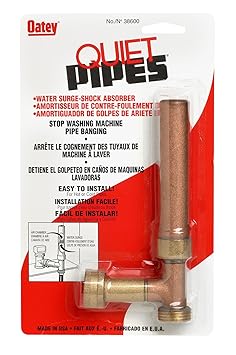

I had a problem with hammer originating from automatic washing machine water shut-off valves. The machine is late-model with electronic controls. I live in a condo with PEX piping and I have been extremely concerned that the hammer (i) will annoy my neighbours and (ii) might cause a line rupture somewhere in the system. So I purchased two hammer arresters made by LynCar for about $20 each (don't know if the brand really matters) and installed them at the wall valves in the laundry room. Some slight improvement but still noisy and worrisome. THEN I read this thread and noted that I should install them as close as possible to the source. So I moved them to the washing machine end of the (stainless steel braided) connection hoses. PRESTO!!!! quiet as a mouse! Thanks for your help!
Thane
Bellingham, Washington
I have the same problem with a new washing machine. I used the the supply box with integral water hammer arrestors for both hot and cold but the hammer is noticable. How did the water hammer arrestor fit on to the stainless braided washer hose?
38,896
4,436
They can be at any orientation.
https://www.siouxchief.com/products...ers/arresters/minirester?template=P3Brochures
Put it on the back of the washing machine for best effect if that fits your space well.

Bumpers are typically only on your washing machines and dishwashers in homes. In BC it is code to have them on dishwashers if I'm not mistaken. I have had to put them in public washrooms as well on flush valve fixtures. And IMO, I would put integral stops on the shower valve. Often when a shower needs servicing it is the cartridge that needs to be replaced, and it is easiest just to pull the trim off, shut off integrals, service valve then turn integrals back on rather than shutting off the whole house and draining everything just to work on the shower. But that's just me
The arrestors come in lots of different configurations. They will last a long time. THey will likely fail eventually, so you will want to put them where you'll have access later on.
