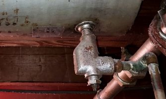

Perhaps this has been the subject of another post, but here goes...
Have a great working old boiler with the old timey expansion tank, (maybe 10 gal) affixed to the basement ceiling. Pretty sure there's no bladder and possibly no air cushion.
As pictured there's an odd looking elbow fitting just below the tank, and there's a small fitting looking like a schrader valve, however it does not seem to be a shrader.
Probably the tank was not setup correctly by our so called heating mechanic who recently installed a new b&g circ pump, and just refilled the system and likely that tank too, probably incorrectly. That's my guess only based on the resulting 27psi, that we've not seen before.
Can anyone share the steps for properly refilling a typical hot water/radiator system with this old style tank (other than the normal radiator bleeding

It's a b&g atf 12 airtrol fitting. That nut on the bottom has a a very small tube attached to it probably 9-12" long about half the diameter of tank. Your extank is a compression tank and they do get water logged. The small tube could be rusted shut and being 70 years old probably won't get it open but it's worth a try since you been this luckly. Need to shut fill off with a hand warm to cool boiler and a floor drain that works. Could pull the tube ant try to clean it or replace the the tank with a bladder tank which will be smaller in size and maybe relocated. Here's the book on it. Since your not at the relief pressure and winter is over might make it for another few weeks.

If that small tube is stopped up air can't enter the tank. If you can drain down the complete system. Can pull that tube and can't unblock it drain tank 100% reiinstall tube tight. Refill system tank will fill at a correct level. Have to get air out through all air bleeds in system. If there are any auto bleeds might want to change them for they might leak from not being used.

First water pressure = 2.31' per lb. Say ex tank is 7' from bottom of boiler to top of tank = 3lbs that why system has to be be drain down to 2lbs to get air into tank by tank drain valve. Going to drain it that low drain the rest out of it. Regardless could be fighting air in system for awhile.
So any pressure in system when ex tank drain valve is open how will air get into tank? After the main pressure blows out then air will suck in and more water runs out. If there was a valve in the ex tank line could just close it and open ex tank drain then after it drains reopen valve feeding it.
