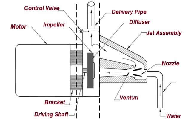

Put the injector down the hole and its called a deep well configuration. If the injector is on the pump its a shallow well. This is making sense now. I don't see the injector part on my pump must be an internal piece. Thanks.Further to LLigetfa's comment, the jet will be located within the ejector assembly within the deep well setup shown below in a 4" casing.
If your pump is not equipped with a removable ejector to allow it to be converted to deep well operation, then your pump will be capable for use for only shallow well applications.I don't see the injector part on my pump must be an internal piece.
Looks like I should be able to see the nozzle portion of the jet assembly inside the pump. I don't see anything in my pumps just the metal case of the pump.
OK just to confirm the terminology here. A deep well jet pump is a pump that is converted from a shallow to a deep well by relocating the injector from the pump to the well. Question: Can a shallow well pump have or benefit from an injector mounted on the pump?If your pump is not equipped with a removable ejector to allow it to be converted to deep well operation, then your pump will be capable for use for only shallow well applications.
A shallow well jet pump will already have the jet assembly inside the pump housing. A convertible jet pump will have the ejector able to bolt directly the the pump to make is a shallow well pump, or it can be installed down the well to make it a deep well jet.OK just to confirm the terminology here. A deep well jet pump is a pump that is converted from a shallow to a deep well by relocating the injector from the pump to the well. Question: Can a shallow well pump have or benefit from an injector mounted on the pump?
The operative word is "jet" pump. There are shallow well pumps that don't have a "jet", only impellers.A shallow well jet pump will already have the jet assembly inside the pump housing.
OK that's an important distinction. All my pumps only have impellers. Do they make pumps with an injector mounted on the pump?The operative word is "jet" pump. There are shallow well pumps that don't have a "jet", only impellers.
There are multi-stage centrifugal suction (shallow) well pumps that have no injector anywhere. They look to me as if they cost more. I don't know if there is another reason that they might be less popular for home wells.OK that's an important distinction. All my pumps only have impellers. Do they make pumps with an injector mounted on the pump?
