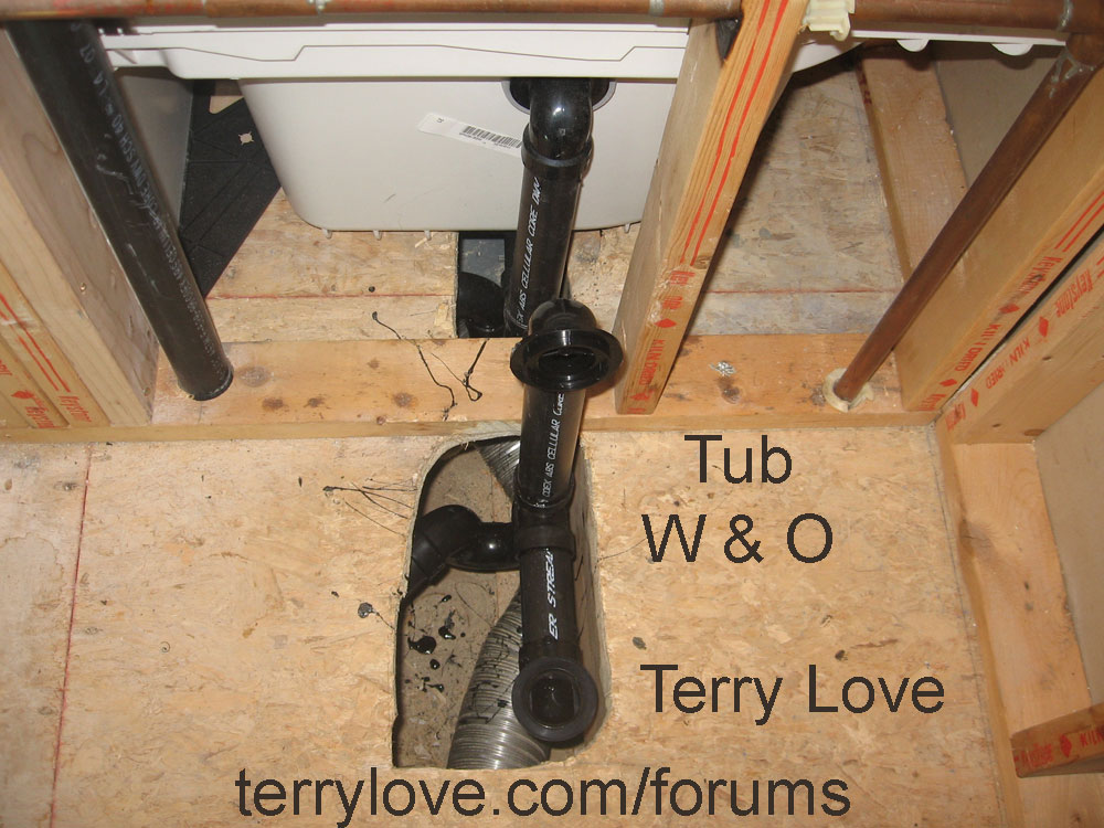

2) Could the fact that the bathtub drain says CLEANOUT have anything to do with it? Does a cleanout go to a p-trap, or is it on the sewer side of the p-trap? I can't find diagrams online -- or even information about cleanouts also being overflow drains -- and am wondering if that may be the culprit? Any ideas on what I should do to figure that out?
Is that cleanout below the rim of the tub? Is there an overflow, other than the place labeled cleanout?
I would plug your suspect hole if practical. I would isolate suspects with cheap thin plastic drop cloths. Lift each, to see if the smell is stronger under that drop cloth.
Is your building served by a city sewer?
How about taping some plastic over both the drain and the overflow? Maybe use the blue tape that pulls off easily.
The tub should have a trap to prevent sewer gas from coming up the drain and the overflow.
You can also pick up a gas detector at a hardware store to check it that way.
https://www.amazon.com/Techamor-Y201-Portable-Combustible-Detector/dp/B07BM1XWB8
If sewer gas is coming up from the tub, then maybe they didn't install a p-trap for that.
Reach4, in the Seattle area, any condo will be on sewer. Septic would be the same issue though.
The overflow is part of the drain.
Thanks for responding!
Yes, cleanout is below the rim of the tub, where you would expect the overflow to be. Looks just like an overflow, but is marked "cleanout". There is no other overflow in this tub.
I will try plugging it today to see if we can isolate it for sure.
Yes -- served by city sewer.
Thank you for the picture and the reply.
I will pick up the tape/plastic today and try that. I didn't know those gas detectors existed, I will look for one of those, too. Thanks. Will report back!
Most of the overflows that are not labeled are still the place to clean out.
Maybe put one plastic drop cloth on the tub, another over the toilet and surrounding floor, and another across the lavatory and its cabinet.

Good to know about the overflow being a typical cleanout. I wondered if that might be the case but I didn't remember seeing it be marked like that before so wasn't sure.
I like your idea of covering each fixture. Will do that.
