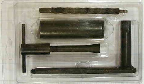

So, my question for the professionals is how much would a plumber have charged to replace this cartridge? I imagine they would have an ONA (Lasco) puller, which would have made this easy, but I didn't want to invest in one.
The original ONA Puller did not work on the 1222 (Posi-temp). We recently came out with an add on tube to rectify this.

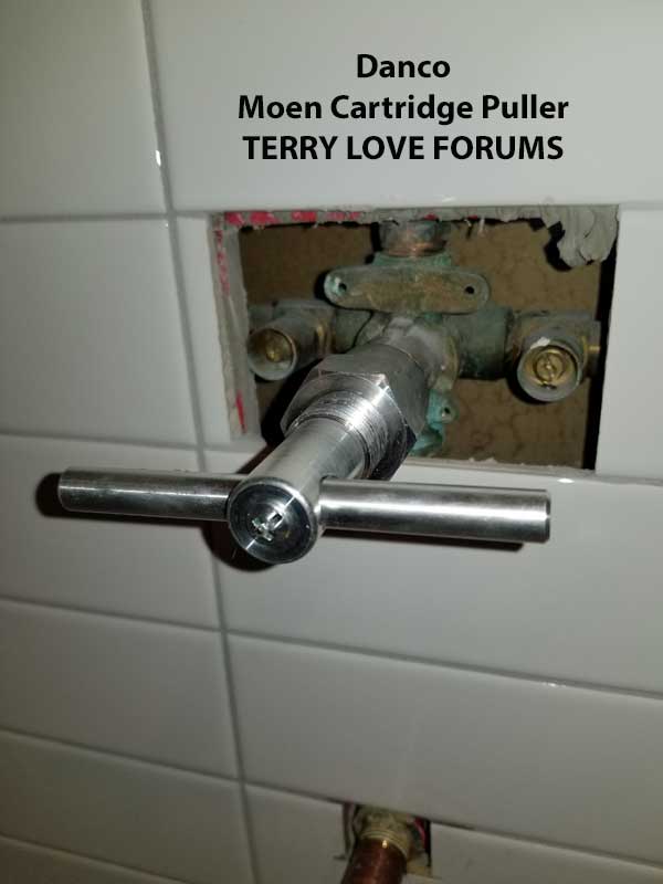

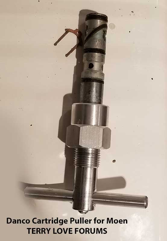

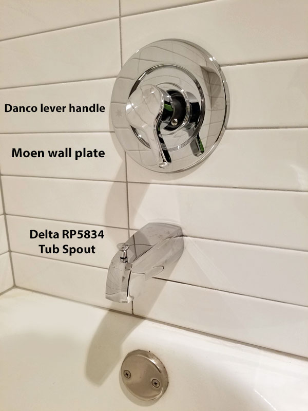

The Danco puller for removing a cartridge from a 1968 Moen Chateau faucet.
It pulled it out rather nicely. And yes, I did try pulling with the pliers first.

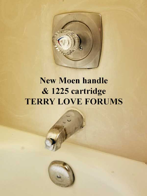

They didn't want the crystal handle I had with me, so I went with the Danco handle replacement. A bit heavy with a new cartridge, but when the cartridge wears in, it will maintain position okay. It's a heavy handle.

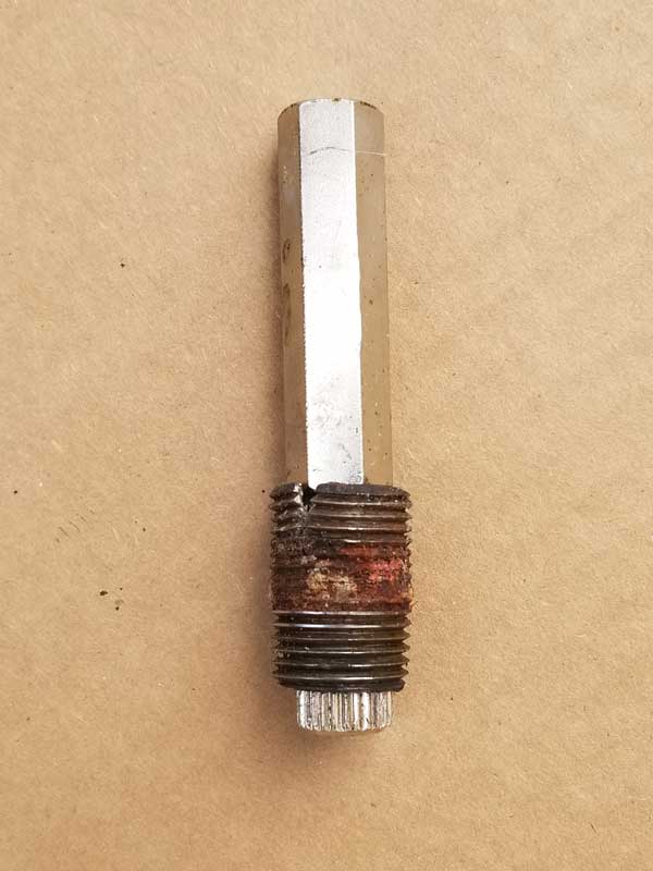

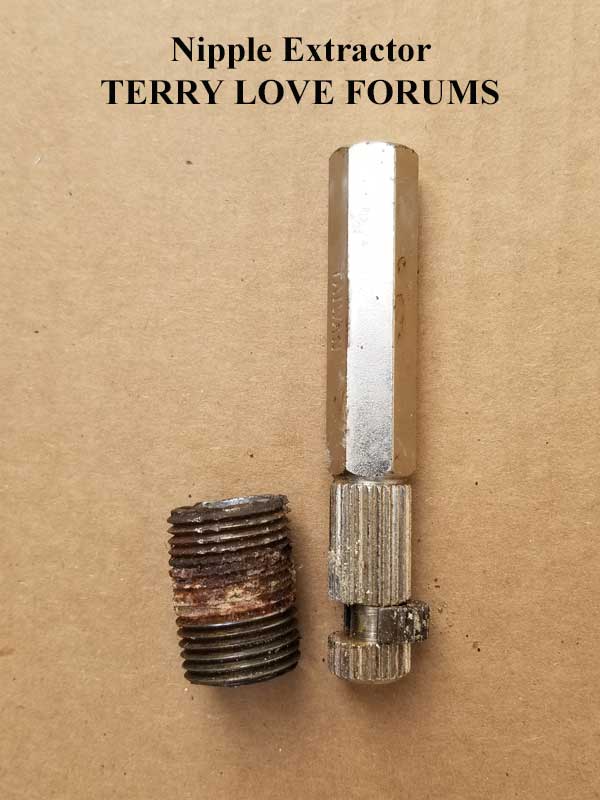

I went with the Delta RP5834 tub spout that works well with a 1/2" pipe nipple. I had two different nipple extractors with me and needed them both. It was in there really, really hard.
Nipple extractor tool used on a tub spout replacement, the post above this one.

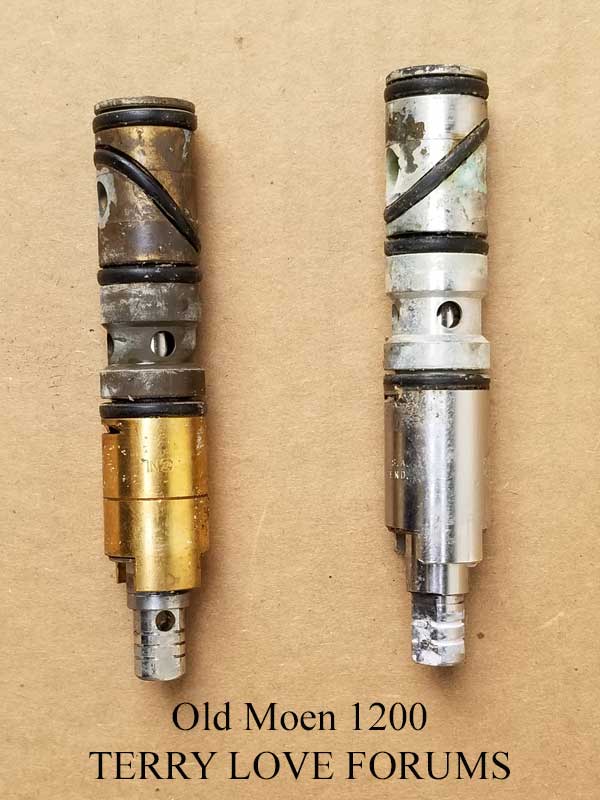

Two very old 1200 cartridges.
New cartridge, new handle. The old cartridge was so still that she had pulled the old handle apart.

Highly recommend the Ona tool by Barry Walters it covers the Moentrol and the Posi-Temp. A must have for all plumbers and their tool box. The biggest recommendation I can give is to be considerate for the next plumber. You can save them a world of hurt replacing these cartridges by simply covering this material with a safe for potable water plumbing grease. This will ensure that these parts will produce less build up that may cause these parts to seize to the valve body and cause stubborn replacement.

I know this is an old thread... but just wanted to add my experience with this issue (and resolution).
Several years ago, I had to replace a leaky Moen cartridge shower valve and the "twisting" type tools were not working at all.
Instead of going to the hardware store for a new tool, I just used some available sockets to make a homemade puller.
I just stacked a couple sockets over the valve and screwed a machine bolt into the cartridge. I also installed a nut and a couple of washers to this bolt prior to inserting the bolt thru the sockets... and then installed the bolt into the cartridge. The nut and washers acted as a puller when the bolt was held in a stationary position and the nut was tightened with a wrench (see image below). I also use this same technique when replacing sink cartridges.

Right on works for you! I've got a couple tools and posted my version of pulling broken cartridge I have them in a kit ready to go.
