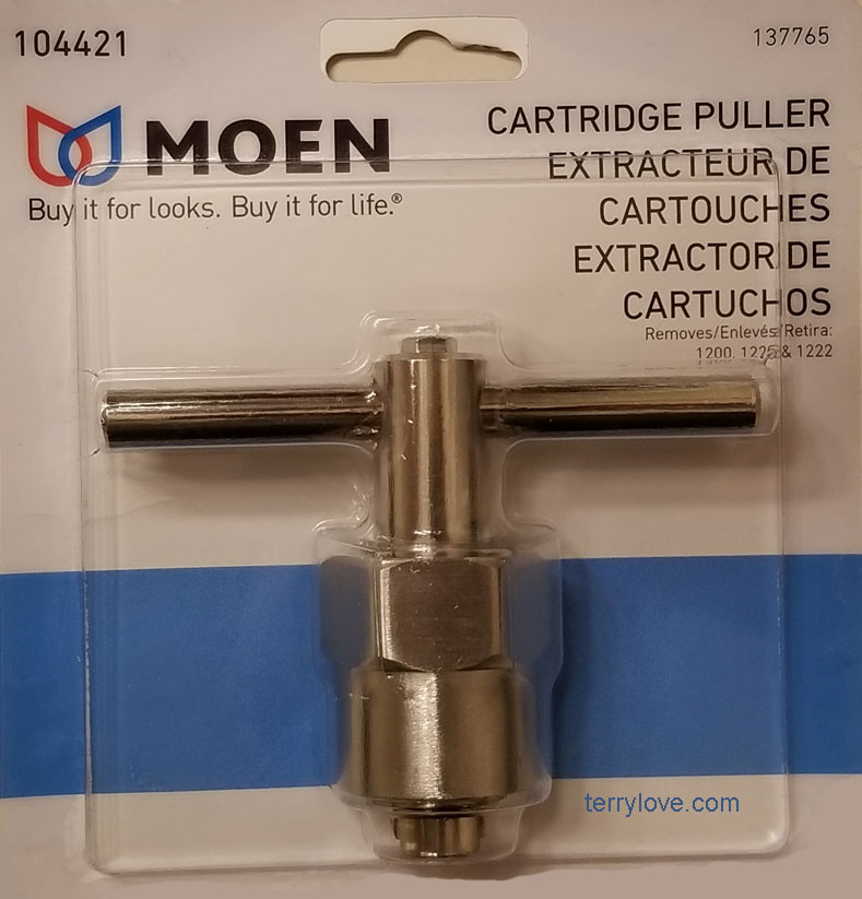

So I go to home depot, and they sell me a single handle replacement cartridge, Says it easy to do. I get home, read instructions and go to pull out cartridge, and nothing, So I pull even harder, and I pull the guts of the of cartridge out, but not the brass sleeve. I went back to store bought a Cartridge puller, but it is the type that screws into the screw hole that the shower handle screws into,(which is the guts) So this does absolutly no good, I tried to spin it with the brass tabs, and they both broke off. So I am stuck with water off, and new shower walls all screwed and liquid nailed into place, what are my options now? Does anyone think the other "T" style puller may work? I am so screwed if i cant get this all figured out.
Here is the puller I bought, and did not work. (It just pulled the guts out)
Do you think I have a chance with one of these?

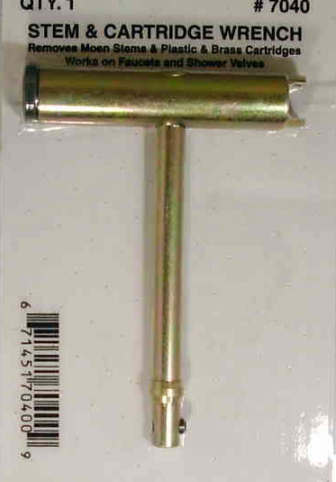

I got the "T" style wrench, and got it in place, it broke the little knob off the end of it. I ended up cutting a hole big enough aound valve to use a mini pipe cutter and cut the 2 water lines and shower line. I then bought a new moen shower package which came with a posi temp rough in. I called around to different plumbing supply houses, and was just about same price for a whole new kit (rough in, shower head, shoer arm, knob & lever, and new plate, I boght a repair plate (which is bigger) to cover where I had to cut hole bigger, But I sweat all th ecopper on rough in then made the connections to the water lines and shower with sharkbite fittings. That way i had no need to put a flame behind wall. The sharkbite fittings are so neat. check them out.
They are like chinese handcuffs. check them out here:

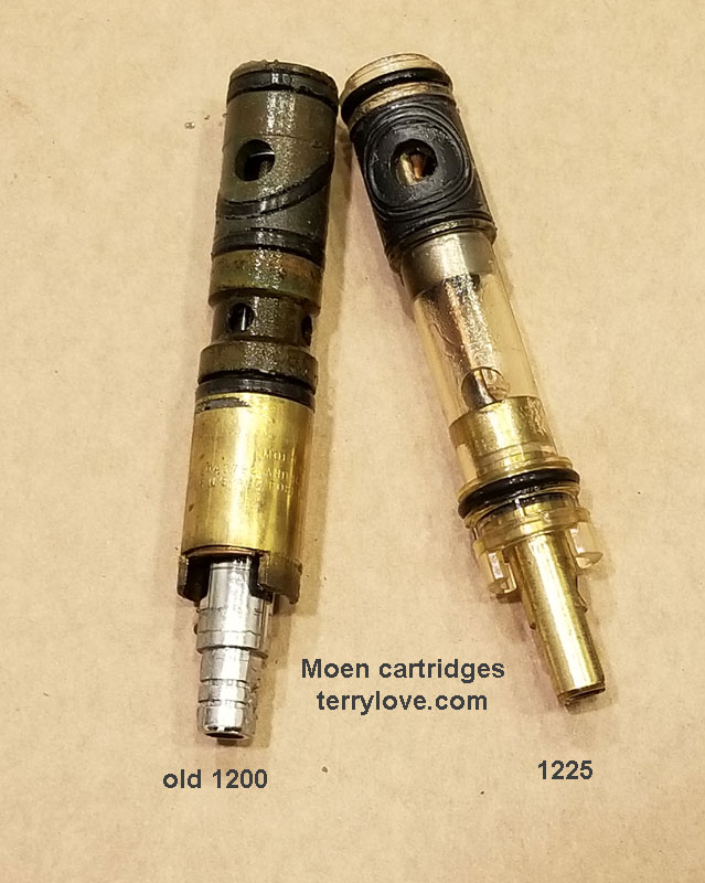

A way to remove the moen no. 1225 cartridge jacket is go to Sears and buy a #5 Screw Extractor. This will cost you about $3.59 plus tax. Before you head to Sears, spray some vinegar and water or some CLR inside and around the cartridge jacket. This will soften the years of calcium bond that has been created. When you return, tap the screw extractor into the hole (gently) just enough for it to bite a little, then take a rachet with a drive to the end of the screw extractor and twist the jacket loose. (This is a much quicker method than the dowel, tap and thread method mentioned.) It only takes about 15 minutes to pop out the jacket and then insert the new cartridge. Make sure you use some water grease (not pertroleum grease) on the new gasket. Slide it in and then make sure you pop the clip in. You might have to test it to make sure you have hot on the left and cold on the right. If not, turn off the water, take out the clip again and twist it around inside then put the clip back in.

We have 4 Moen 4600 faucets in our house. House built in 1969. One just started to leak and so I took it apart and pulled out the core of the cartridge leaving the sleave behind. I then broke off the ears of the old sleeve trying to pull it out. At that point I was just going to buy a new faucet but I decided to come find a forum which lead me here. SewerRatz post from 12/25/08 above made my day!! I bought a 3/8 dowel rod, cut 1.5 inch piece then used a 1/2 tap (the inexpensive T&D set that I bought did not have a 5/8) and I backed out the old ugly looking sleeve in about 2 minutes. I cleaned out the metal shavings, applied some plumber's grease to the cartridge, inserted it into the faucet and we have running water in that sink again. If any of the other three 4600 cartridges go bad before we remodel then I am set. Thank you very very much!!!! Dan

A pipe easyout or a straight blade screwdriver works for me. Don't even own a regular moen puller. A couple of times I have removed the spout and used a little heat to remove a stubborn cartridge. Like Redwood said just rotate it to loosen it and then pull it out .

I seem to be reading tales from some "lucky people" who managed to wrest their Moen cores out without destroying the body. Unfortunately, others who try the same methods might not be so lucky. The proper tools, and the knowledge of how to use them, are critical in most cases. I have had to replace valves that were destroyed by "creative" DIYers trying to improvise their own methods of extraction. It did not make them feel any better when I told them it would have only taken a few minutes and a lot less of my time and their money, if they had called BEFORE starting, or at least stopped two minutes before the reached "their level of incompetence".
