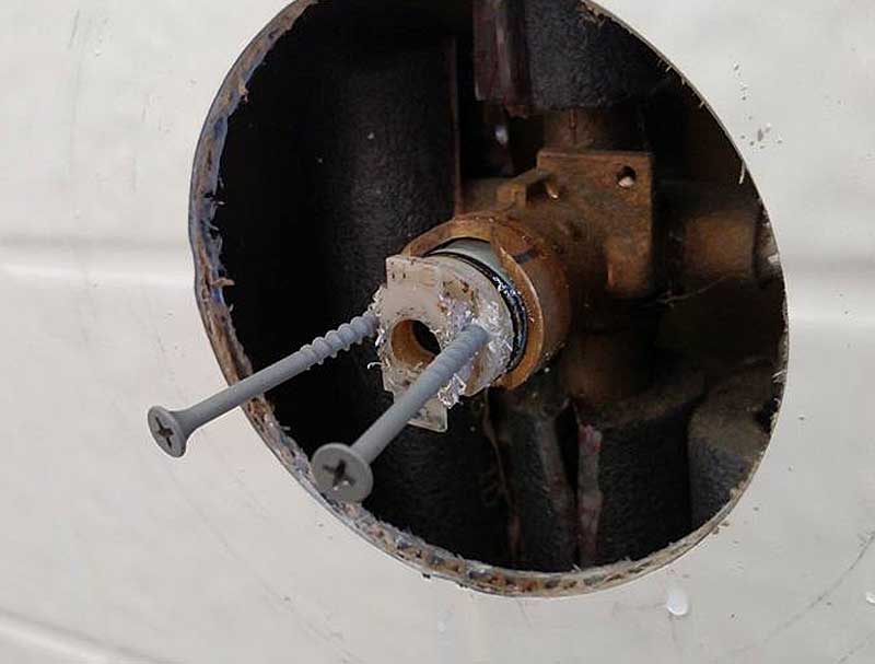

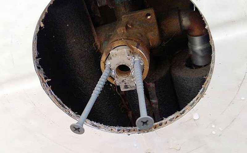

Easy removal of cartridge
Im a non-pro so was tackling the cartridge removal with some novice trial and error...
- I did remove the clip...
- Broke the cartridge tabs after trying to turn it 45 degrees clockwise with the dinky plastic removal tool
- Unfortunately, the core post had already been broken off (was reason for repair), so no tap and die solutions possible with MOEN removal tool.

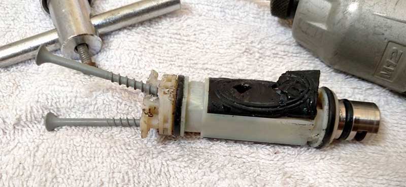

- So.... I drilled a small hole throught one of the broken plastic tabs till I hit the metal cylinder within
- Used a thin screw through same hole, when it hit the metal cylinder it actually pulled plastic cylinder portion out ~ 3/4"! Enough to get pliers on to complete the job.
Quite by accident but no special tools necessary! Picture below (note I had drilled 2 holes in case I needed another screw which I didn"t).

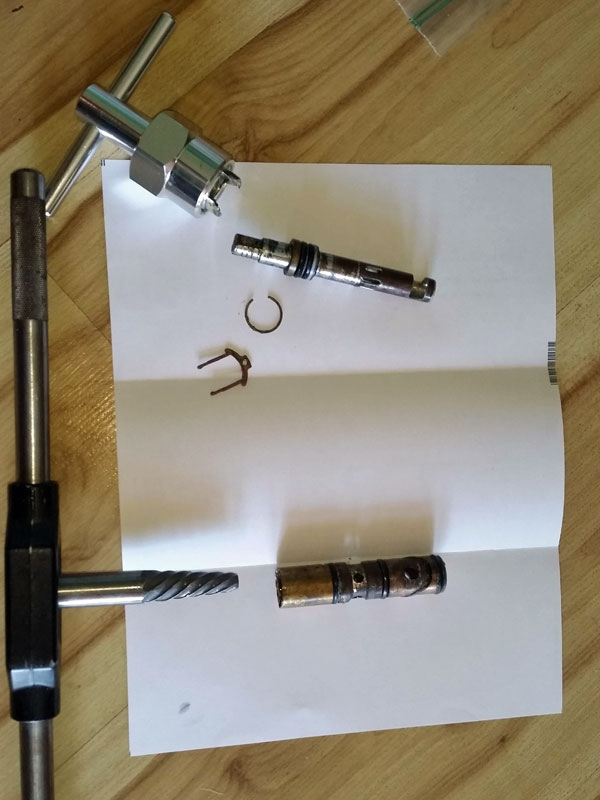

Bought a Moen cartridge extractor. Tried turning to loosen, snapped off both tabs eventually. Ended up pulling only the core, leaving the brass shell behind. Oh F@#K! Apply liquid wrench, get on Google, find this thread! Seems the common solution was using a 1/2" tap. I tried the #6 bolt extractor which did the trick in seconds, literally. Photo at link below. Thanks, internet!

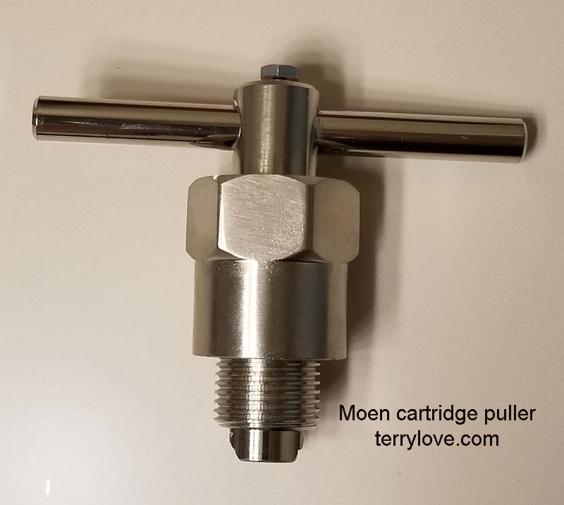

3,481

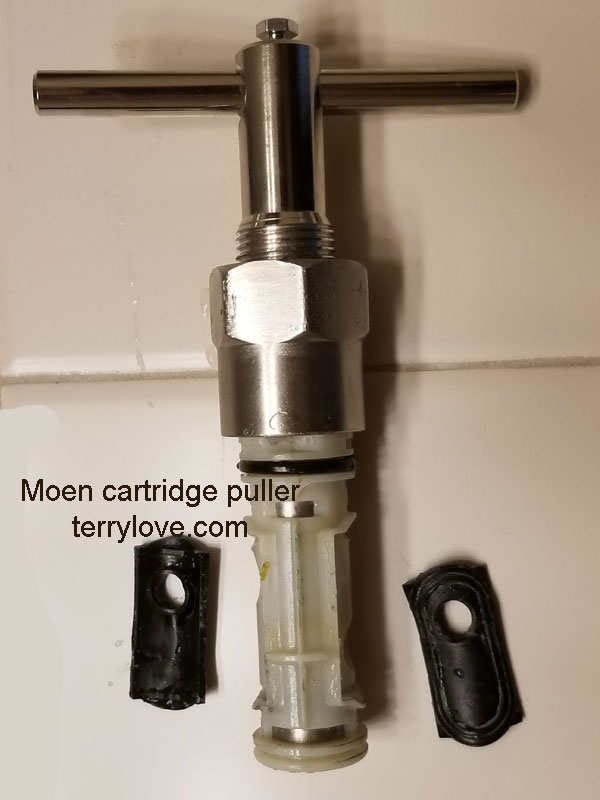

These cartridges can be difficult to pull. This one was pretty broken up by the time it was removed.
This works way better than the little plastic tool that comes with the cartridge.
This pulls the old 1200, 1225 and the Posi-Temp 1222
Some other comments:
I use a long screw .. hammer and a 2x4 ... screw the screw into the remaining cartridges ... put 2x4 agains the wall/tile .. use hammer like you are removing a nail putting pressure on the 2x4 .. not the tile

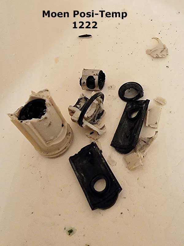

I just finished replacing a PosiTemp 1222 in the shower and it was a colossal PITA but ended in success. I thought I'd share some things and I have a question for the professionals.
First let me say that of all the information that I viewed prior to tackling the job, the discussions here were by far the most useful. Since I am an engineer I went into the job with a handicap (the professionals are chuckling because they know what I mean) and I was under some pressure from wifey to get the thing fixed, but I had to do it quickly as my son, his wife and my newborn grandson have been here quarantining and I didn't want the water shut off for long.
I bought the 1222 cart, some Danco faucet grease and a puller from Lowes for $62 with my veterans discount. I had taps, easy-outs, bolts and washers on hand just in case.
The cart turned 45º easily and then with the puller installed started coming out about a quarter inch. At that point I figured that "this is a piece of cake". Well, it wasn't cake after that. Basically it took two of us twisting, pulling and cursing to get the thing out. I am just glad it didn't break off in there. After it was free it left small pieces of rubber stuck inside the chamber and luckily my son's 27 YO eyes were able to help him get them out with a needlenose and some hooks.
