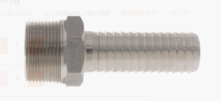

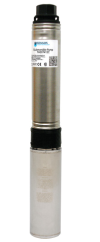

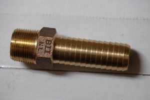

My new 1HP pump is like my old one, and has a nylon discharge head. I am planning to use 1 1/4 poly pipe 160 PSI with 1 1/4 stainless steel barb fittings.
I've watched various videos and most people seem to use only pipe dope/sealant on the barb fitting into the top of the submersible well pump. I was wondering is there a reason for this? Is this the recommendation to use dope instead of tape? How much do I have to worry about overtightening and breaking threads?

With a SS fitting and a Nylon head too much Teflon will act like a wedge and cause the head to split. Teflon paste will make it too slick and the pipe can tighten in the Nylon head too far and split the head or hold the check valve down. I would just run it dry and tighten the fitting well. But if you want to use something try Rectorseal, as it is not as slick and will set up and get hard in a short time, which helps prevent unscrewing.
However, I have welded steel pipe to the steel couplings and the pump still came unscrewed when there was too much cycling on and off. Eliminate repetitive cycling and unscrewing the drop pipe becomes a non-issue.

Thanks! I assume the same goes for the fitting attaching the poly to the pitless? I should just use rector seal 5?

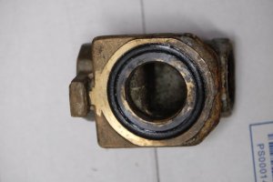

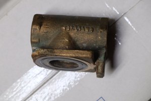

Also, do I need to do anything to prep my pitless to be installed back in? There's a bit of grim I figured I would carefully wash off without touching the o-ring.

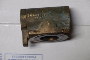

It's an extra long barb like in the first post. If I replace o-ring, should I scrub off the rust or use rust remover?
My pitless has the name williams on the side of it, but it just looks like a generic pitless..., nothing special about its style? Could I just get a off the shelf pitness and use the new drop in half?
38,903
4,438
If you cannot ID the pitless to go get a replacement o-ring, see https://terrylove.com/forums/index.php?threads/leaky-pitless-adapter.90975/ including #11. I expect prices have risen.
That said, many reuse the o-ring. Lube with silicone grease whether new or reused. I like Molykote 111 for seals that do not deal with movement once installed.
As far as the rust, I don't think the pitless is rusting. I think that is just an iron deposit. You could probe around the pitless with a magnet to see that nothing attracts a magnet. On flat surfaces, I will sometimes use a single edge razor blade... never did that on a pitless however.
So I am not sure if scrubbing would be right, or you will want a paste of Iron Out.

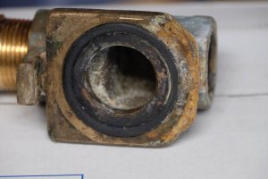

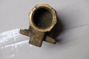

Whereismyhat
19
Lake County, IL
Five minutes with some warm water and paper towels later...
Is there any other sign besides leaking which would indicate necessary o-ring replacement? My o-ring looks ok.
My plan is to use rector seal 5 with the barb fitting and the pitless adapter like @Valveman suggested for the barb and the pump head. Yeah, I know i need a few SS band clamps for the long fitting and the pipe.
