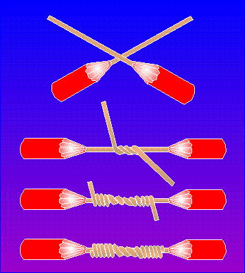

When it comes to making the wire connection at the pump, I don't use the crimps that come with the heat shrinks. I wrap the wires around each other and then solder them. That way, the wire might support the weight of the pump.

Here is how to make a strong splice that also is a good conductor and unlikely to generate any heat.

Properly crimped butt splice connectors will hold the weight of a pump just fine.... I never install torque arrestors of rope, and on residential stuff like this, I use sch 120 PVC sure-align pipe that comes with integral threaded bells, and I do use a dab of dope, which really aids in getting it back apart late. I agree with Valveman, with metal couplings you have to be careful with PVC pipe from screwing it up too much, dope might make that even easier to do than it already is. As far as unscrewing, pumps usually run in a direction that would tend to unscrew the drop pipe.....proper torque on the drop pipe prevents this; 10 ft./lb per HP of motor....so it really doesn't take much torque on a little pump like this to not have to worry about it. I really hate poly pipe as drop pipe, but if I were you, especially since its not very deep at all, I think you should just get a roll of 160# poly. 20' sections of threaded PVC can be brittle and weak if you don't have a way to lift it straight up...and if you try to do it but hand swinging and swaying around while you screw it together, I'd worry about it breaking. I've seen people screw up a 200' long string of 1" pvc with a pump and wire on the ground flat, and then curve it up and put it right in a well by hand, but I'd never try it.

Good “Sta-kon” butt splice connectors are plenty strong when you need them to be. I have pulled many pumps by the wire. Once I pulled a 75 HP from a 600’ deep well with the wire. Of course the wire wasn’t any good when I finished, but the splice held.
