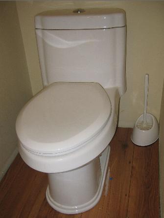

Costco Waterridge dual flush
So I decided to pull it up one more time and sure enough there were no leaks around the flange/wax seal so I just cleaned up the wax pieces and re-installed the new one. Still some dripping sounds but now they're different than before (quieter and not the steady streaming sound but it goes on for longer than before) so looks like everything's A-OK, although the toilet's flush leaves a lot to be desired (it seems that the default settings are too weak, so I adjusted the flusher to give a more forceful flush however the water doesn't seem to be directed properly so I readjusted the amount of water in the tank by adding a filled handsoap bottle of water to displace the amount of water). This seems to correct things somewhat by having less water forced out.
dripdripdrip
northofthe49th
Just replaced an upstairs toilet with one of these babies (after not being too impressed with another manufacturer's toilet I installed downstairs) and it works awesomely! Buttons seem to work properly for me (smaller sized wavy button is on the right and larger one is on the left - lifted the tank cover and verified that on the flush tower inside the tank the one on the right has a 1/2 moon symbol and the one on the left has the full moon). No problems flushing at all and I gave it a good workout!
(One thing to note, this one-piece does not have a lined tank but I guess that could be addressed if condensation ends up being an issue with a DIY styrofoam kit similar to the MOEN one I saw the other day at Home Depot)

This one seems to have a problem when you use the 3 liter flush for I would say a significant "load" but if you use the 6 liter flush, everything works perfectly.
In the first place, the 3 liter flush is NOT for "significant loads", so if it plugs up then, it is a "user error", not the toilet's problem. If the 3 liter flush was for EVERY purpose, why would they bother having a 6 liter option.

Same problems as everyone else, but the biggest one issue is
1. the sticking of the flusher buttons. If I don't catch it they can run for hours. My partner doesn't hear the water going and going and going and going for ever! It happens frequently and I really have to hammer on them to get them unstuck.
2. The bowl isn't deep enough and indeed when standing up to urinate it will splash EVERYWHERE! I'm not one to sit for number 1.....
3. The shallow bowl also leaves skids with number 2, very embarrassing for company.
4. And there really is no clear visual difference between the liquid and solid buttons.
5. Now I'm starting to get clogs...... I think it's gonna go back as soon as I find a better one.

I've had one of these Costco Water Ridge dual flush toilets for about 3 years, about 6 months after I installed it, I had problems with the sticking of the full flush button causing it to run. I tried adjusting all adjustable items on the flusher assembly and even replacing the assembly with a new one (taking advantage of Costco's return policy), none of these worked. For 2 years I ended up pushing the button a second time when the bowl flushed, this worked but my company could never follow instructions. I was about ready to replace the toilet but thought I should look at the flusher assembly a bit closer. The sticking button problem is because they have a poor design (bad angles) with the linkages inside the assembly for the full flush and they didn't lubricate them properly. I removed the flush assembly and let it dry out completely (2-3 hours), then I sprayed a water repellant lubricant inside through the holes onto the linkages and onto the flapper on the bottom (for good measure). The toilet button doen't stick open or run anymore (2 weeks so far, cross my fingers for months). I used Jig-A-Loo (orange can) but any equivalent like a silicone or lithium based spray should work. Hope this helps.

Sounds similar to a problem my Dad had on his American Standard. Basically the flap in the tank wasn't closing/sealing tight because a piece of the rubber gasket from one of the tank screws had managed to work it's way between the flap and opening allowing water to slowly drain into the tank thereby causing the tank to partially refill (that flushing sound you're hearing).
The mechanism is different on the WaterRidge one-piece but the principle is the same in that it sounds like you're not getting a good seal at the opening from the tank to the pipe that leads to the bowl compartment. check to see if you need a new seal or if the drop-valve mechanism isn't lining up properly to seal that hole.
(To confirm that this is what's happening, a common suggestion is to add a few drops of food colouring to the tank and then wait your 20sec. and see if the colour makes it's way into the bowl water before the flush sound).
