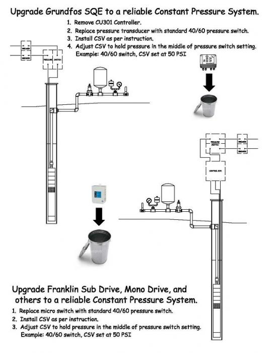

Just run the power through a regular 40/60 pressure switch before it goes to the pump. Then you can add a Cycle Stop Valve later to stop the pump from cycling on and off, and to provide the constant pressure you need. See diagram on how to replace a CU301 controller with a Cycle Stop Valve.

regulad 40/60 P.S install exactly where
1) between pump and 2gal blue tank?
or
2) between 2gal blue tank and water softner two tank with salt box?
or
3) after water softner tank?
thanks
Valveman
Cary Austin
14,633
1,303
Lubbock, Texas
cyclestopvalves.com

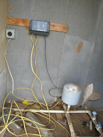

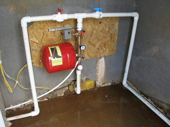

Before softener, as close to little blue tank as you can. Probably the same place as where the pressure transducer is now. Everytime I have done one of these, the little blue tank is also busted from the high pressure. If you have to replace the tank, get a little larger one, like 4.4 gallon size. Here is a before and after picture of one like that.

See the diagram above. The switch goes at or just after the 2 gal tank and the CSV goes before the tank.
I have "check value" very close to the blue pressure tank, so my question is can I install CSV between this check value and pump?
or I must install CSV after check value and before blue tank?
or maybe this existing check value doesn't needed, so replace it with CSV?
Thanks..
Valveman
Cary Austin
14,633
1,303
Lubbock, Texas
cyclestopvalves.com
The CSV needs to go before the pressure tank and pressure switch. There must be a check valve on the discharge of the pump. You don't need another check valve anywhere else. You can probably put the CSV in place of the check valve, as long as it is before the tank and switch.
