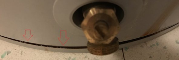

Hello all,
I have a 7-year-old GE Geospring hybrid water heater that has recently acquired some rusty looking streaks on the exterior of the tank. The bottom/pan of the tank appears to have bulged a bit away and I can see some wetness in there. I have indicated that area with red arrows in the last photo.
Can anyone help me diagnose what the problem is and what I should do about it? It apparently has a 10-year manufacturer's warranty for parts.
I must admit I have not inspected the anode rod, although this has been on my to-do list for some time. I do have an expansion tank installed as well as a water pressure gauge that consistently reads about 50 PSI. I've never actually used the conductive heating elements - it has always been used in heat pump mode. I last drained the tank about 2 years ago and there was very little sediment.

You need to remove those covers to inspection the heating elements threaded into the tank. If the hybrid unit is on top, condensation might be the cause as the drain line could be clogged. Do turn off the power first. WH tanks usually will leak wherever there are welts. The threaded connections are welded to the steel tank, then coated with porcelain.
Electric WH do no get much sediment built.

Tonight I removed the covers and found the upper heating element is leaking as shown in the last photo below. The metal cover and styrofoam allows the hot, leaking water to condense on the cooler metal surface and then drips down to the metal pan/seam and is causing the corrosion/bulging of the bottom pan as shown in the OP.
The lower element seems to be fine (no photos).
GE has a 10-year parts warranty. Does anyone know how they will handle this problem? I don't see how they can supply parts that will fix this.

I think the fix may be as simple as a bad gasket, but may need to replace the element if the gasket surface is corroded as Fitter30 mentioned.
I'm going to try calling GE warranty and see if they'll send me a new element and gasket.
