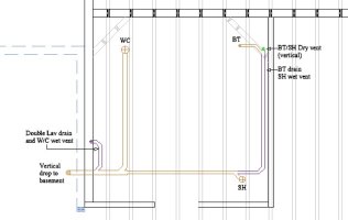

Greetings everyone ... a few months back I posted questions on how to properly vent my bathroom I am putting in. There was a lot of great info from different people, including Wayne, but I did not want to tag off that post to avoid confusion, so I am starting a new thread with a specific question.
For background info, I am putting in a bathroom group consisting of a double lav, toilet, free standing bathtub, and stand up shower (see attached layout pic). I am in NH, and the IPC is the governing rules. The challenges I am up against are that the area below the bathroom is garage space, so I would prefer to have all plumbing be inside the wooden I-joists. The joists are 16" deep, but to maintain slope, I really only have 5 1/2 inches of drop from bottom of the subfloor to the point of entry into the main house where it will go to the basement and tie into the main septic pipe. The other challenge is that there is no good vertical wall in the direction of flow to dry vent the appliances, and IPC does not allow horizontal dry vent below the flood rim of the appliance.
What I would like to do is wet vent the whole bathroom group via the double lav 2" drain. The 2 lav drains will meet in a vertical double cross, and the 2" dry vent will extend up into the attic part of the garage and out the roof. Since I live in a cold region, I will increase the dry vent from 2 to 3 inches in the climate controlled part of the house before going up to the attic/roof. The bottom of the cross will serve as lav drains and wet vent for the toilet, shower, and bathtub. See attached diagram, and the purple colored pipes are the wet vent.
Please feel free to comment on whether this meets Ch. 9 of the IPC, as this is the simplest and straight forward solution in my (non-pro) opinion. If it won't work, then I may have to go back to other solutions, such as directing pipes to a vertical wall, even if it means going in the opposite direction or through floor joists and back again. If any part of the wet vent piping needs to be upsized to 3", I am open to that as well. Thank you in advance.

I'm pretty sure we covered all of this in the other thread. You've go two problems with your layout above:
1) The distance and drop from a trap (shower, tub, lav) to its vent (wet or dry) is limited based on one pipe diameter fall, which give a maximum length of 8' for a 2" trap at a perfect 1/4" per foot fall. The only vent connection you have for the WC, shower and tub is that wye in the lower left where the lav drain comes in to wet vent everything. Way too far from the tub and shower traps.
2) More basically, with wet venting, every fixture needs to be vented as it joins another drain. So the lav can wet vent everything if it is one of the two upstream most fixtures. I.e. you'd have to have the following order of connection going downstream:
2" double lav drain -- fixture 1 joins in -- fixture 2 joins in -- fixture 3 joins in.
The order of the fixtures don't matter, just that they join the double lav drain one at a time. And if fixture 3 is the WC, then the pipe between fixture 2 and fixture 3 needs to be 3".
Cheers, Wayne

Now, the above layout would work if you dry vent the tub. E.g. you could pull a dry vent into that diagonal wall by the tub. That could be an AAV in an accessible wall box with a grill if you can't get a vent through the roof from that diagonal wall.
Cheers, Wayne

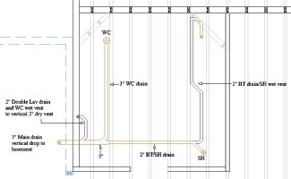

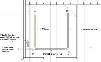

Thanks for the reply Wayne. I did not think I asked about wet venting the whole bathroom through the lav last thread, but maybe I did ... it had more than a few side bars.
I did not take into consideration that the dry vent part of the wet vent system had to be upstream. I thought I was ok with the trap arm distance for the tub because I made the assumption that the 2" pipe coming from the tub trap was the start of the wet vent (even with water draining at the same time, the air from the lav dry vent could make it back to the tub). Now I think I understand the wet vent concept better. My flow was bathtub as the most upstream, then shower joins it, then toilet, then finally Lav. I can understand now that the tub drain would not flow well or siphoning out the tub trap because vent being so far away.
So what I hear is I need to dry vent the tub somehow, and that could be the start of the wet vent, being the furthest upstream appliance. The only problem is, although the tub and shower traps are in the same joist bay, I would either need to either go back to the diagonal stub wall, which would involve doing a 180 change in direction, or go into the next joist bay, catch the corner of the stub wall, and back through the joist and on from there. See pictures of both situations. Let me know if either would work and which would be preferable. Once in the stub wall, I would be able to get the vent pipe up to the attic area to join the lav vent and out the roof.

Scenario 8 works and clearly involves fewer changes of direction, so that's better.
You have the option to use a 1-1/2" tub trap and then a 2 x 1-1/2 x 1-1/2 wye or combo (with the barrel horizontal) for the vent takeoff. I.e. the tub drain after the dry vent has to be 2" because it's a wet vent carrying more than 1 DFU. But you could also use a 2" tub trap and then a 2x2x1-1/2 vent takeoff.
As long as your showerhead(s) add up to less than 5.7 gpm, the shower counts as 2 DFU, and the combined tub drain/ shower drain / wet vent for the WC is only carrying 4 DFU and can be 2".

I think you are correct… #8 is more straight forward as far as changes in direction. The only concern is I would lose about an inch and 1/2 of slope because I have to go through the I-joist below the flange, but I think I will have just enough slope to make it work.
I was thinking of using a 2x1.5x1.5 wye with a street 90 degree 1.5 for the vertical dry vent, and the 2 inch branch of the wye for the wet vent downstream. See picture … I only had a 2x2x2 to use as a prop but hopefully you get the idea. Thanks!
