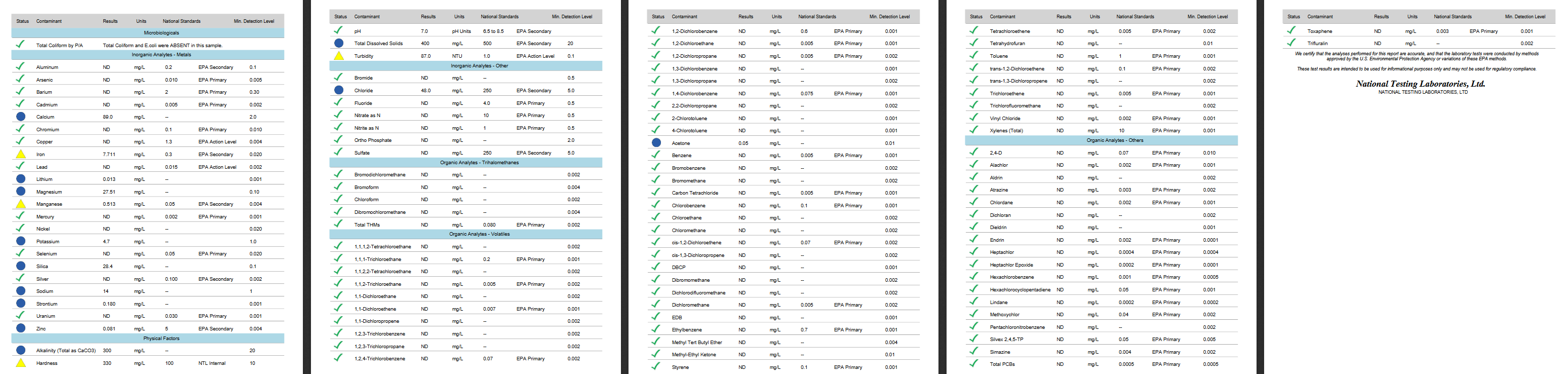

Bought a house that has a birm filtration system that isn't doing the job. Would like to replace the existing equipment with something that will work. Going to remodel the inside in a year or so and don't want the new bathrooms to orange like the current tiles.
Based on reading here, I went and had NTL test my well water. There is Iron Bacteria (not tested, but my toilets have lovely black scum). Here is a summary of the test, with the complete test attached as an image.
Iron 7.711 mg/L
Manganese 0.513 mg/L
Hardness 330 mg/L
Turbidity 87 NTU
Calcium 89 mg/L
Lithium 0.013 mg/L
Magnesium 27.51 mg/L
Potassium 4.7 mg/L
Silica 28.4 mg/L
Sodium 14 mg/L
Strontium 0.18 mg/L
Zinc 0.082 mg/L
Alkalinity 300 mg/L
Total Dissolved Solids 400 mg/L
Chloride 48 mg/L
Acetone 0.05 mg/L
pH 7.0
Iron Bacteria is present
Local place recommended an Ozone injection system to avoid Chlorine, another one recommended running two softeners in series. I see a hardness and iron problem and would rather address those with a filter and then soften after. All I know is what I've read here though, so please feel free to send me down the right path.

Ummm, no. Ignore the "specs" on most equipment. It may technically work for a short amount of time but you are asking for trouble with that type of low end unit. Adding air to bacteria will do wonders for increasing it even higher.
Iron 7.711 mg/L Very high
Manganese 0.513 mg/L Very High
Hardness 330 mg/L Moderate, easily treated
Turbidity 87 NTU Expected due to high iron
Calcium 89 mg/L
Lithium 0.013 mg/L
Potassium 4.7 mg/L
Silica 28.4 mg/L High, not worth treating
Sodium 14 mg/L
Strontium 0.18 mg/L
Zinc 0.082 mg/L
Alkalinity 300 mg/L
Total Dissolved Solids 400 mg/L Moderate, ok
Chloride 48 mg/L
Acetone 0.05 mg/L Likely due to new plumbing, this will usually drop quickly
pH 7.0
Chlorine injection, contact tank, to kill the bacteria and remove the majority of the iron, in order to properly design a system for you, we would need to know what type of well/distribution do you have. Can you post pictures.

It really comes down to budget vs. quality of water desired. Do you mind a little maintenance in order to get better quality water?
Since you have not treated for iron bacteria in the past, a simple sanitizing of the entire plumbing and well system may be all that is needed.
A simple and effective treatment method and something that could be added onto later if needed may be the way to go. A simple micronizer air injector before the galv. tank. (replace that with a new tank) then into a Katalox Light tank, then into a softener. Did they split the water to go to two Birm Filters?

Did you sanitize the plumbing when you sanitized the well? Everything must be completely disinfected or the bacteria can return in a short amount of time.
If you just want to do it right, no problems, then a simple chlorine injection, contact tank, carbon tank, BB sediment filter then a softener should do the job.
