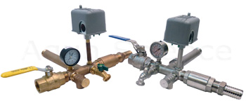

I have something like this. That would make sense though because it is definitely not working as a check valve. Good learning experience.

Both of those tank tee kit images have check valves, that you would normally have been better to leave out. Now that you have that in place, it will be interesting to see your photo.
Something like and exactly like are not the same thing. As reach4 said, both those have check valves. They are the cylindrical object with barb nipple threaded into them. Also both show the drain cock on the tank side of the Tee so it makes sense that opening that drain cock will drop the pressure.
The check valve should hold some pressure when the pump is turned off so long as water is not used, i.e. the drain cock and ball valve are both closed. The check valve will mask a leak between the pump and the tank. It is also illegal in several states. A leak between the pump and tank can reverse flow and suck contaminated ground water into the well.
