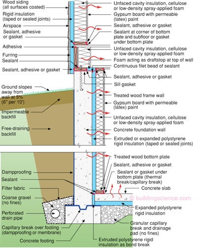

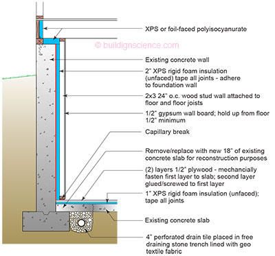

Insulate the walls as if it were a hobbit-basement. Columbus OH is in US climate zone 5, where for the above grade section of the walls at least R5 of foam would be enough for wintertime condensation control using an R13 (kraft faced or unfaced but not foil faced) studwall. An inch of foil faced polyiso would be the preferred foam board if going with a studwall + foam option. For an all-foam option it takes R15, which would be 3" of paper or fiber faced roofing polyiso, or 2.5" of foil faced wall sheathing polyiso. Leave an air gap between the bottom edge of the foam and the slab, given the seepage history. Any foam needs to be covered with a timed thermal barrier against ignition. Half inch wallboard is fine, even if unpainted. But in the studwall + foam option paint the wall with at least a primer coat to serve as a vapor retarder.

You'll have to pull back the foil faced batts of the crawlspace ceiling to adequately air seal an insulate the band joists, but it's otherwise fine to leave it in place.
It's best to use cut'n'cobbled foam board can-foamed into place at the top of the foundation and band joist, but as long as it's at least R5 it's fine to use care R15 rock wool (more fireproof than fiberglass) to fatten up the R-value there rather than stacking up R15 or more of foam-board:
^^^This diagram isn't enough foam for a foam-only solution, but shows what to do at the top of the foundation and band joist.

If you're installing 12 mil poly (6 mil isn't rugged enough for a "walkable" vapor barrier) or EPDM (membrane roofing) AND foam board, the vapor barrier only needs to come up 12-16" up the wall. It can be glued & taped to the wall prior to installing the foam board, but ends up being sandwiched/clamped between the foam board and foundation. If you are installing a furnace down there the fire ratings of the vapor barrier are goint to matter if it's on top of the slab- I'm not sure if 12 mil polyethylene would cut it, but I'm pretty sure EPDM roofing does. Run the plan by the inspectors BEFORE installing any of it.
Yes, the polyiso foam board from Menards would be fine, but reclaimed roofing foam from commercial building re-roofing/demolitions can be cheaper & better.
Do NOT use standard construction adhesives- they have solvents that will degrade the foam board. There is specially formulated foam board construction adhesives that won't affect the foam. If installing an interior side studwall or furring to trap the foam to the wall and mount the fire-resistant thermal barrier (half-inch wallboard is good) you won't need to use any cap-screws. If it's furring rather than studwall, use coated masonry screws through-screwed into the foundation.
Unless you live in a termite zone the inspection strip isn't necessary. If you DO live in a termite zone, insulate the inspection strip with carefully trimmed rock wool batt that can be removed for inspection and re-installed.
