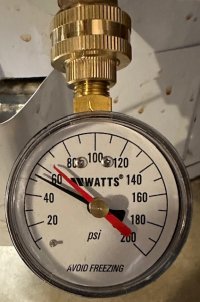

To determine if you have a closed system, connect a garden hose thread pressure gauge. Take a hot shower, turn off the water, and do not use more water. Immediately go to the gauge, and see how high it rises. Alternatively, take a time lapse movie of the gauge during the shower. It the water pressure goes up lets say 30 psi while the WH recovers, your system is closed. The water meter may have an internal check valve.
You can connect the gauge to a laundry tap or the drain valve of the WH.
Using no water includes not flushing the toilet.

Well I did the pressure check after taking a long shower and then watching the pressure gauge and no one was using any water to release any pressure and it looks good to me! The lower pressure readings in the pics were when I first got out of the shower and the other pic was after a long time where it stayed consistently the same. I did position the “tattle-tale” red indicator to record the highest pressure as it went up.

So can I absolutely assume this is an open system or are there just systems where they leak down to make you think they are?
I think so.

Just my opinions > Your pressure tests demonstrate you do not have high pressure issues.
