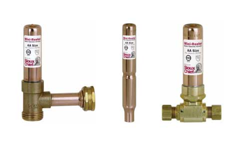

The one on the left is for a washer.
The one in the center can be soldered onto a tee.
The one on the right can be used inline like for a lav supply or an icemaker line.
