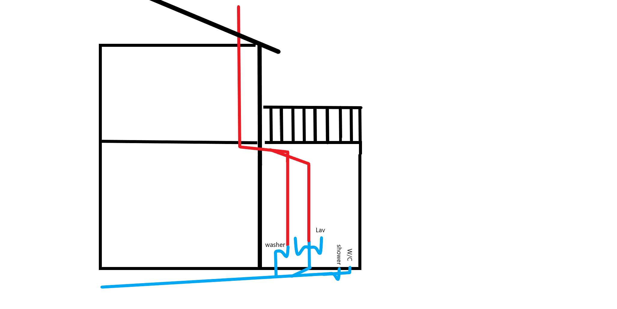

What about this layout: Wet vent the WC from the lav into a 3", the shower and and washer standpipe connect into a 3" and are separately vented and the two 3" drains connect together and then go to the main sewer stack under the house. All 2" vents/revents merge into one 2" vent up to the roof via the interior wall?

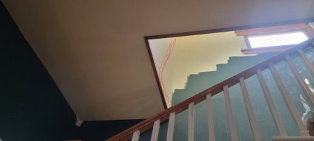

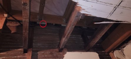

This project is complicated by the fact that I can't run vent up into the crawl space along the long exterior wall because of the porch header/beam from the original porch seen in picture 2. Then the fact it's a roof deck. :mad:

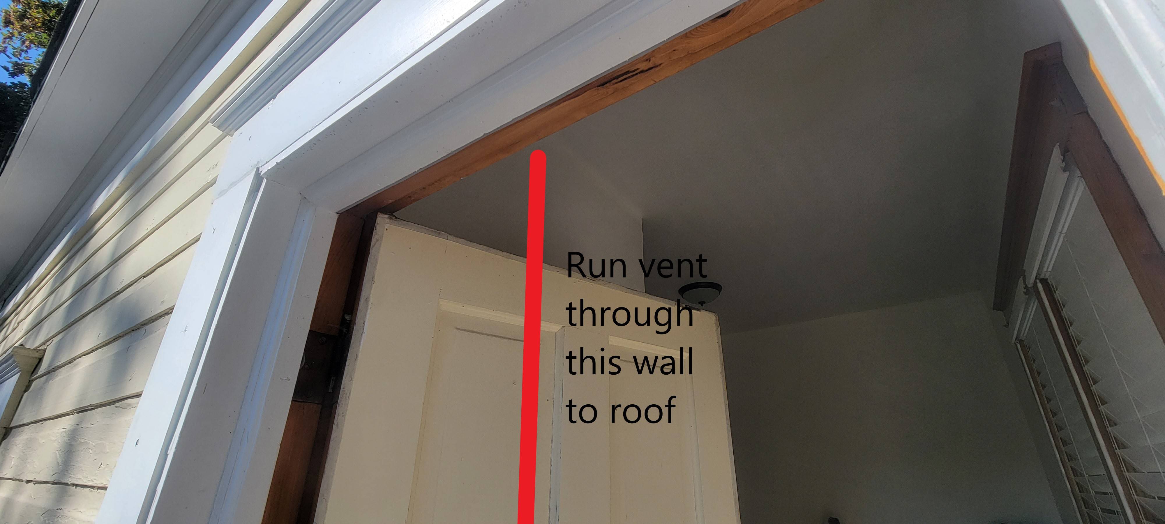

I'm trying to get a vent pipe into that wall above the stairway. There's an L shaped office I think I can get into. But that means the entire bathroom unit + washer standpipe will be going into a 2" vent. DFU calculation works out.
Any concerns with this plan or alternative ideas?

The total aggregate vent area through the roof needs to be at least the same as a 3" vent. So when you combine your (3) 2" vents, you need to make the combined vent 3" and run 3" out through the roof.
Also, the lav dry vent needs to be 2" (as it wet vents the WC), but either the washer or the shower vent could be 1.5". But not both, as 1.5" pipe + 1.5" pipe + 2" pipe < 3" pipe, while 1.5" pipe + 2" pipe + 2" pipe > 3" pipe.
The WC needs to be wet vented within 6' from closet flange. That distance is measured from the closet flange, along the pipe run (including the vertical portion) to the wye where the lav drain joins it.
Otherwise, the drawing looks fine for venting. I didn't review the earlier part of the thread or look at the photos or drainage routing.
Cheers, Wayne

Got it, so close... So there's no way to get less than a 3" pipe through the roof, huh? That wall is non-load bearing that I want to go up through, so I can go through the entire bottom/top plate if needed, but getting it between the top plate of the 1st story exterior wall (see circle in picture) and the decking ledger board is going to require some cutting.
Would you mind just taking a quick peek at this drain diagram? I'm realizing now I don't need the fancy cleanout where the lav drain starts, I can just put it directly into the 3" WC drain. otherwise does it look kosher for UPC?

On the drains, the combined washer/shower drain could be 2". IIRC 2" horizontal is good for 8 DFUs, and a shower is 2 DFU, a washer is 3 DFU.
The shower drain routing looks like you're going to use a san-tee under the floor for the vent take-off and then a LT90 to go back horizontal. That's fine if you can afford the drop, particularly if you need the flexibility to make arbitrary angle turns in plan. If you'd prefer to avoid the drop, and can move the vent takeoff to the right within that wall segment, there are other vent takeoff options available besides a san-tee.
My only other comment is to check the angles between the horizontal drains, you have a lot of angles that seem not to be the 45 degrees given by a wye. Which is an issue if all the horizontal segments are to be in the same plane (roughly, given the 2% drop on each line).
On the 3" vent requirement, that's assuming you're showing all the drains in the house (if you've said otherwise earlier, I've forgotten and didn't go back to read). If you have other vents through the roof, then they count towards the aggregate area requirement. Everything you've shown could be vented on a single 2" vent otherwise.

I see that, I was seeing that for IPC (we use UPC) a washer must terminate into a minimum 3" drain after the 2" washer fixture pipe. To reduce any change of shower backup issues, I was just gonna upsize to 3" at the combination of the shower and washer fixture drains.
Everything here you said is correctly assumed. I like your idea of moving it to the right to avoid drop if needed. I can put a 2x2 combo there instead
Yes, they'll all be 45 degree wye when in plane. Should have written that out before I email this plan for my inspector to review. I'll write in the angles.
I have a main stack located in the center of the house. See where the blue line terminates on the picture below. It appears then that I can use a 2" vent and either:
1. Revent it to the main stack vent in the attic, or
2. Send it straight up the roof as proposed
Does that sound correct?
