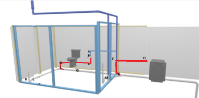

So here is a rough idea of using a single VTR for the bath group. Line L-J must be 6 ft max if 1.5 inch trap and pipe, and 8 ft if 2-inch trap and pipe.

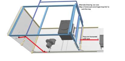

There is some disagreement as to whether you can bring in the toilet to get wet vented from above. If you bring the toilet waste in from the side, everybody will like that. H-C is in the wall or fits behind the toilet next to the wall, perhaps in a floor soffet (I don't know the correct term for a box where baseboard would go), but you could bring that below the floor instead. I have another picture with an alternate idea.

All the fixtures are going to be on a 2nd floor studio space, so underneath is a garage with ~10' ceilings. They will eventually tie into a 4" pipe exiting the structure and going into a new septic being installed.
Dry vents cannot run horizontally unless 6 inches higher than the flood level.... The dry venting has to take place before the drainage turns down more than the diameter of the trap arm.
Ok, so I understand that is why my previous design wouldn't be to code due to the horizontal dry vent in between the tub and toilet fixtures.
The lav will need to be dry-vented, but it could wet vent the shower and toilet. You would need to run a 2-inch drain(wet vent) from the lav, over to the left, perhaps in the wall, and feed that into the path within 8 running feet (IPC) of the output of the shower trap. A wet vent can go horizontal under the floor.
You mentioned previously the lav (p-trap to the right of the toilet) would need it's own vent, but wouldn't it be considered part of the bathroom group and eligible as part of the horizontal wet vent? If not, I imagine I would be able to connect it opposite the kitchen sink in the same manner using a double santee like the image below.

I think that would also work to vent the lav. Turquoise 4-port fitting is a double fixture fitting. I think you want the kitchen waste expanded to 2 inch beyond the trap adapter. Also, kitchen waste is higher probability of clogs, so a cleanout would be good.
Tub cannot wet vent something higher. Lavs are high, so they need to be dry vented, but they can wet vent other bath stuff. It is possible for a lav to wet vent a lav.

Ahhh that's the missing piece of the puzzle. Thank you for explaining that. That explains why all the technical drawings I've seen always use the lavs for the vent since they are the highest point.
In that case, I think I'll plan on doing the double santee since most of the rightmost side of the bathroom area is going to be cabinets that I can hide the pipe in, similar to the kitchen sink on the opposite side.
So my new layout for the tub drain area seems to be near identical to your second image (img_7), and then I changed both the sink and lav to run horizontally until they reach the vent. So unless I'm forgetting something, would it be safe to assume this design would get a pass?

While there exists a double santee, you want the one called the double fixture fitting.
See place P.... how to implement a vent and a turn takes some thought. One way is to run the vent into a santee on its back, and continue to a long sweep to make the turn.
Charlotte PVC 311 is
Long Sweep 1/4 Bend,
with Side Inlet
ALL HUB
3X3X2(PVC)
However you would be looking for 2x2x2. So the 2x2x2 santee followed by a long sweep uses available parts.
A santee on its back would be positioned such that a bug running down the vent would be directed away from the tub trap. You could also use a combo, which would be usable for UPC as well as IPC.
