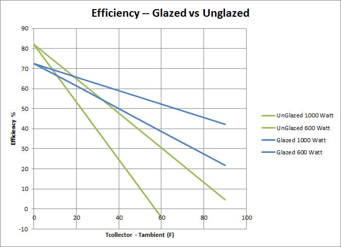

I have a solar heater for my pool that is 100' of black landscaping pipe tightly coiled on a piece of plywood that I painted black.
It works in the heat of day, but not as efficient as I would like.
I have to run the water through slowly and I use a secondary pump.
My question is this...
Will I get more heat if the whole operation is covered with plexiglass? I was going to test this with some clear plastic wrap like a clear plastic drop cloth.

You'll get more heat out of it with a higher pumping rate and lower output temp. Unglazed solar collectors are VERY efficient when run at low temp, (say 90F collector output, in 70F outdoor air). If you let it run hotter than that it's re-radiation and convected losses eat into that.
Glazing cuts into efficiency by reflecting back a fraction of the solar radiation, but allows it to run at higher temps with lower loss. But the performance of the glazing is also quite variable, depending on it's material. Commercial flat plate collectors use low-iron glass with selective coatings to squeak a bit more out. Polycarbonate (Lexan tm) greenhouse glazing works better than plexiglass, but still isn't as good as even cheap clear glass.
For what you'd spend in glazing to do it right you'd be better off buying cheap commercial unglazed pool heaters (or getting them for nearly-free on craigslist or something.)

You want the difference in temperature between the water coming into the collector and what's flowing out to be 20F or less (eg: 68F pool water, 88F water coming out of the collector), but if the delta is much less than 10F you're probably chewing up more pumping power than it's worth. It depends on the absolute efficiency of the pump.
