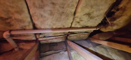

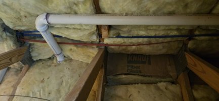

Also if it helps any. This bath is on the second story over a garage. The 1.5" pvc is ran through the wall and steps up to 2" inside an attic area over the front porch. Hopefully the pics help this make sense!
