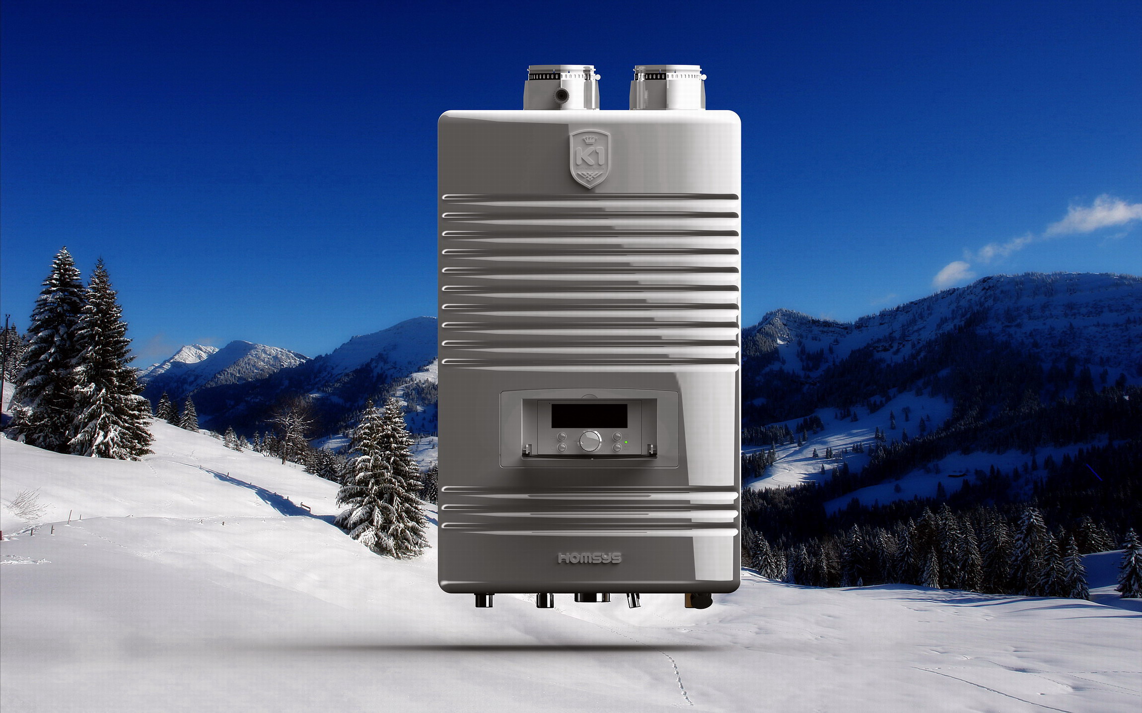

BTW: It appears that HTP (and several other companies' combi boilers) are the Kiturami Homsys under the tin:
It looks like HTP was importing far more than just the heat exchanger! (Can't keep a good design down, I guess!)
Looks like the Korean competition for the North American market is warming up- Navien is a trademark for Kyung Dong Boiler. I'm liking Kiturami's fire-tube heat exchanger approach better than Navien's dual finned water tube heat exchangers on their boilers.

^ interesting..... the plot thickens!
Unless something unforeseen happens- I'm still pretty much set on the HTP/Westinghouse UFT.
Looking at the control board of the Korean boiler- it has a few less features (no night setback for space heating/DHW, no smartphone app, no three color display, only one vs. three T/T contacts, etc) than the Lochinvar- but at less than half the price- I can scrape by without those features. I could literally buy a whole second Westinghouse UFT and keep it in storage for parts and still be a tad under the price for the Lochinvar.
And... the HTP/Westinghouse is direct piped so no boiler pump, less electric use, fewer moving parts- and simpler near boiler piping.
