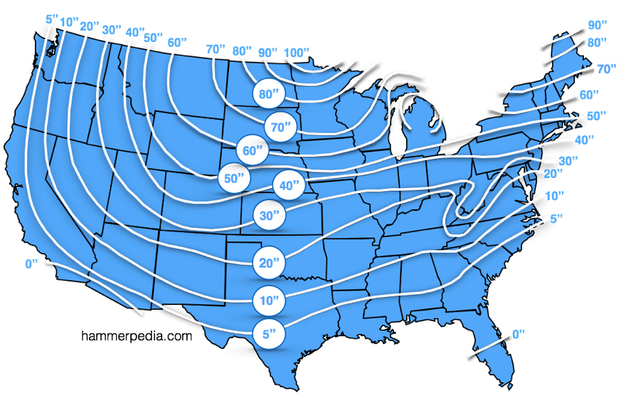

Your main line from the well pump what size is it and the material. What is the water pressure coming into the house? Heres a frost line chart don't think your line is deep enough.

So part of the problem trenching the line was the presence of ledge around 5’. That’s why we lined with blue board (double on traffic areas so it prevents the frost from pushing down). I was always taught that 1” blue board is as effective as 12” of dirt. We have 1 inch poly from well to pressure tank, and a large pressure tank (40 gallon or so). I have not had any water freezing on the supply side except at the very entrance to the tank where it was exposed to the elements. This has been corrected and insulated, and I don’t foresee an issue. The pressure switch is a 40/60 psi cycle. If I open the bottom valve on the tank I could spray water across town because the flow is so high. Same with opening the 3/4 valve at the end of my line, which is what makes me look to the branches.
