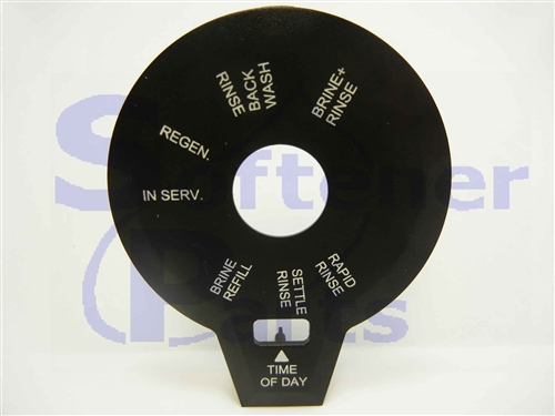

After getting it back together, trying to set it up again, I notice that the clear program wheel with the numbers moves freely. I believe it used to have to be pulled out before it would move. Is this a problem?
Found the part:
Link
Softenerparts.com support seems to think I need that part, so just ordered it.
