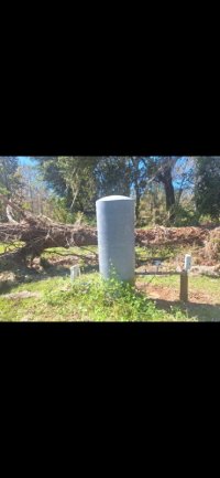

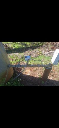

Good Afternoon everyone,
I just found this site as I am looking for a solution. For my problem. I inherited some land and a home from my dad after he passed away in 2016. Since then my well problems have been worse and worse. He had it drilled in 1995 and it's 250 feet deep with plenty of iron. The pumps and a lot of other parts constantly go out. Now I'm looking for another solution because I have spent a lot of money trying to maintain this well and nothing is working. What I am thinking about is adding a 1,200 gallon cistern to tie into my current system. I would want to collect rainwater to go into the cistern. The well is about 25 yards from my home. I would want to place the cistern about halfway between my home and well tank. My roof is 62 feet x 24 feet(4 bed and 2 bath). What I would like to do is run the piping from the cistern and tie in before my pressure tank. Would I need another pump to get pressure into my tank from the cistern or can I just let the water flow naturally into the pressure tank with a check valve? I will add some pictures of my current well setup. Please excuse the tree as I'm still trying to clean up from hurricane helene

Sorry for your problems. Iron can be a pain. Galvanized tanks like that are used to aerate the water to get rid of the iron. But the galvanized tank and air controls can be more of a pain than iron. The tank does nothing to the iron in the well, which can also clog up the pump. I would switch to a diaphragm style tank design using a Cycle Stop Valve. If the galvanized tank and controls is allowing the pumps to cycle themselves to death as usually happens, the CSV will solve the problem and make the pump last a long time. That is, as long as the pump doesn't clog with iron. I would use a larger tank like 86 gallon size (20 gallon draw) rather than the normal 4.5 gallon size (1.2 gallon draw) tank with the CSV. The larger tank will allow the pump to stay off for a long time when a Sulfur Eliminator is dropping 1.5 gallons an hour or aerated water down the well. Aerating the water in the well should keep the pump from clogging up. Check with the guy that makes the Sulfur Eliminator to see if he agrees.
Thanks for your insight I never thought about changing the tank and installing a Cycle Stop Valve.

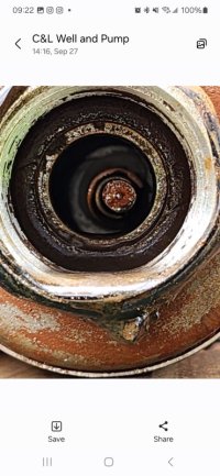

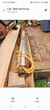

This is good to know about the cycle stop valves!!! Here's are some pics from the last pump that went bad.
jaws2003
11
32344
Got any more pics? Can't tell what the left one is. Are those two pics of the same pump?
No. I wish I did. Its a top view of the pump. Those are the only two pics that my well guy had sent to me but they are of the same pump.

The top is not blown off of the picture on the right. If that is the same pump it must just e the check valve inside the pump that is missing. Check valve failure is not caused by the iron. Check valves fail from slamming shut and flying open as they do with the old air over water tank type systems.
Thank you sooo much!!! I'm glad I came here as am learning new things and gaining knowledge. It's misinformation in my local area that I'm being told that makes me angry. So correct me if I'm wrong this all still leads back to still getting the cycle stop valves and converting to a bladder style tank? Then that will solve a lot of my woes with the well?
