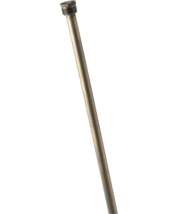

80 gallon AO Smith residential electric water heater and well water. The water heater is 9 years old. Starting with year 2 I have replaced the anode rod religiously every year and flushed the tank. Each year the removed aluminum rod is completely encrusted with heavy calcium deposits that even wire brushes will not remove. I have changed heating elements a few times and each time the failed elements also have heavy calcium deposit buildup. The water has no sulfur smell.
I bought a powered anode rod (Corro-Protec) but am reluctant to install it since I cannot find information about how it and calcium will interact. I would like to know what happens to the calcium in the water tank that now is deposited on the standard anode rod. Anyone know, or have other pertinennt information or advice to share? Thank you.

Suggestion = Next time you service your unit pull the lower element and remove the sediment with a wet vac. Attach a length of automotive heater hose. I do mine every six months checking the anode condition through the element holes ... I replace both elements every time.
41,270
4,968
Idea: if you can measure the current going into the anode (I would guess a few milliamps), you can look for a long-term drop. The current would go down because you are attracting ions to the shell of the WH, and those may insulate some. The anode attracts electrons. So I don't see that tending to lime up.
I will comment that you don't need high torque to put an anode in. But you need high torque to get the one from the factory out.

1. Normally aluminum anode rods are used to reduce generation of H2S. Magnesium rods protect the WH better.
2. I agree that changing an anode every six months seems like way overkill.
3. My powered anode is no longer sold. If I were buying a new one, I would be thinking about one of the A O Smith units with the longer electrode. One of the items I looked into a while back is https://www.supplyhouse.com/AO-Smith-100305721-Product-Preservers-Powered-Anode-Rod-System
I suspect that http://productpreservers.com/ is related to AO Smith, but I am not sure.
Here are some more links that I have not tested lately:
Powered Anode, Shielded,.118 Diameter X 31.5
SKU: 100111286 AO Smith CURRENT LIKE!
https://www.hotwater.com/lit/spec/com_accessories/apcpp18003.pdf (19+ inch)
https://www.hotwater.com/lit/brochures/apcpp18002.pdf brochure overall
#100324744 is supposedly for bigger
https://www.gsistore.com/products/lochinvar-a-o-smith-100305721 shows power supply and more.
4.http://waterheatertimer.org/Replace-anode-rod.html has some useful anode info.
5. I wrote a post on powered anodes a while back. https://terrylove.com/forums/index.php?threads/powered-anodes.102546/

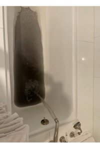

I’m curious how this worked for you. I also have an 80 gallon ao smith (LTE-80D) on well water got it in Oct 21. I just got home from being away for four months and for the first time I had a strong rotten egg smell, and then the hot water started coming out of tub brown with tons of sediment usually I have some sediment, but I’ve never seen anything like this. .
I flush the tank a couple of times. The sediment seems to be gone or perhaps on the the bottom of the tank and the smell is down but not gone. Was wondering if you have any recommendations I have never changed the anode. I don’t have much clearance above the tank so might need to use a segmented replacement or try the powered. Any suggestions ?
How did you see sediment in tank and clean it out?
Thanks
