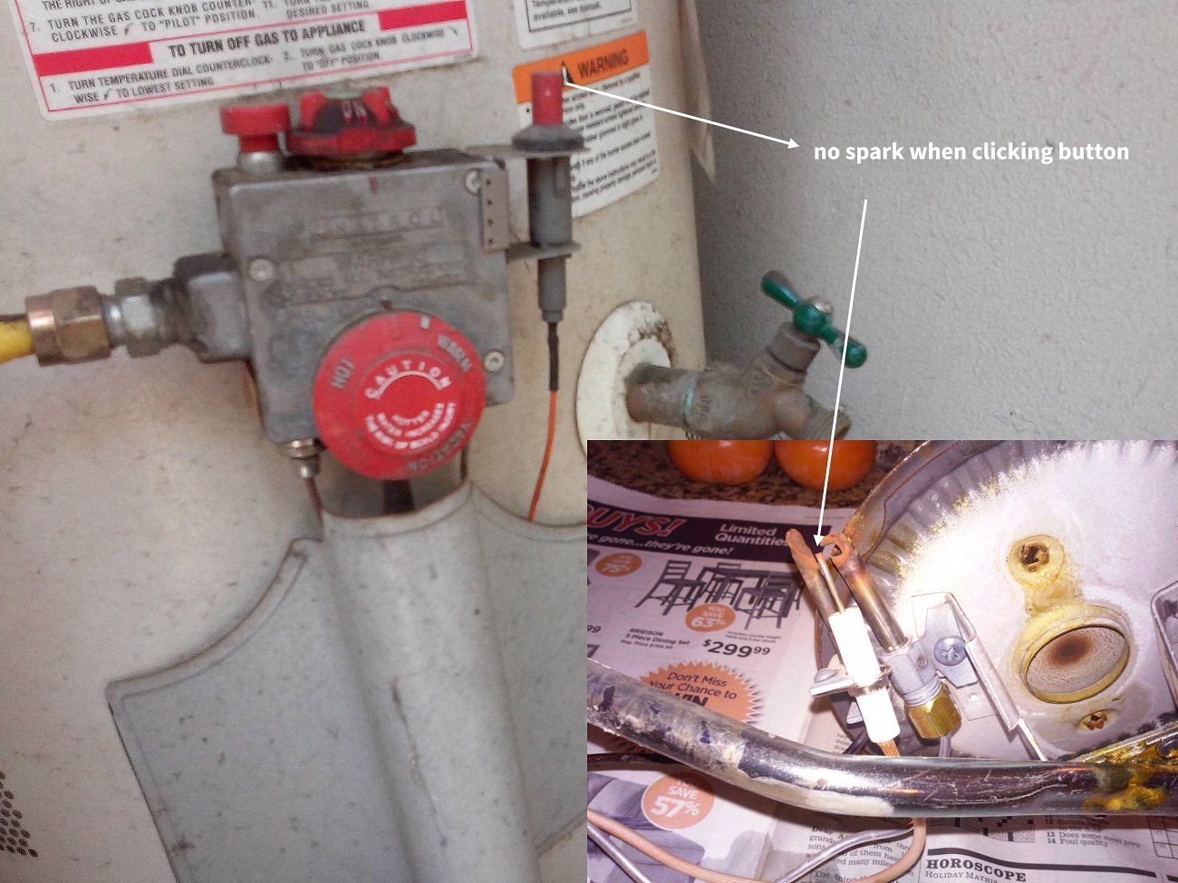

pilot went out and wh won't light up anymore on this GE 50 gal.
pushed the igniter and no sparks were seen.
I removed the whole burner assembly, along with the igniter switch. Clicked it a hundred times. no spark.
I did shock myself while holding the assembly while clicking the igniter, whatever that means.
So I dunno what's wrong.
Isn't there supposed to be a spark?
I can't find an exact replacement for this igniter.
I checked both gas lines in the burner assembly, and they both flow properly.

Looking at your 2 pictures, this pilot assembly looks worn out, so I doubt the pilot light will be able to stay on for long.
I strongly suggest you get code compliant by replacing this water heater, let's face it, you are going to have to replace it sooner or later, might as well do is sooner.
One thing you don't want to do is start replacing parts: gas valve, burner assemble - parts that can easily be as much as a new WH.

i don't know if the assembly was damp or something.
but this morning, I pressed the igniter, and there was a tiny spark. Barely noticeable. Maybe it was there last night and I didn't see it.
I thought the spark would be bigger.
I took apart and cleaned out the pilot nozzle, which had crud inside, put the burner assembly back in the wh, and it lit right up.
up and running now.

From the style of drain valve, I'd guess that water heater to be well over a decade old. And the amount of rust and metal erosion on the thermocouple and pilot flame holder indicates that this heater is on its last legs. The pilot went out for a reason.
You should do as DJ2 suggested and replace the heater. Now that you have it working again (temporarily), you can shop around and replace it proactively, rather than as an emergency.
