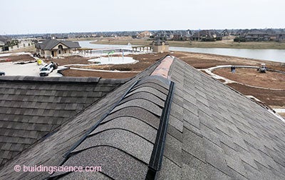

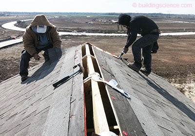

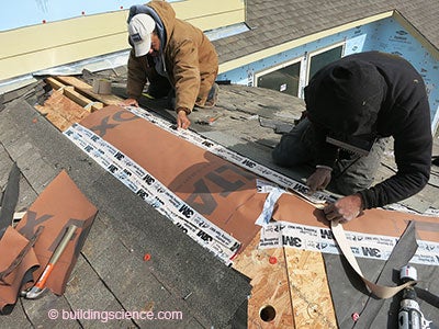

I've recently been looking at "diffusion vent" schemes for using fiber insulation in unvented roof assemblies as a cheap but still fairly moisture safe way to insulate at the roof deck. With a diffusion vent the soffit vents are made air tight. The ridge vent is made wide by removing ~3" of roof decking on both sides of any ridge (including hips of hipped roofs), but made air tight with an overlay of highly vapor permeable shingle underlayment, and covered over with standard ridge venting mesh & shingles.
It's a bit outside of code prescriptives- the code inspectors may throw a fit, but there's plenty of reason to believe that it will work in US climate zone 2A, Mississippi.
Read this.
And this.
On a 12:12 roof installing a diffusion vent isn't likely to be a DIY job for most people, but air-sealing and insulating the attic and underside of the roof deck from the interior might be.
