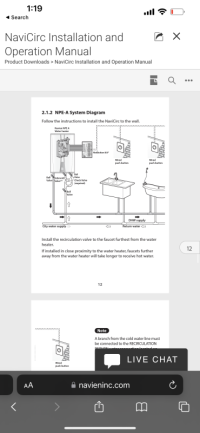

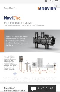

For whatever reason, Navien has conflicting information all over the place regarding the proper installation of the comfortflow/navicirc system.
Do I still need to hook up the cold to the recirc port with a check valve above the tee if I am using an A2? The technical drawing from the NPE-A2 webpage (under pdf, not CAD) makes it seem like they don’t require it anymore, but I can’t be sure based on conflicting information on their website.
I believe the documentation for the navicirc tee is still from the NPE-A series and not updated for the A2.
However, the comfortflow/navicirc webpage specifically says A2 yet still shows a tee on the cold side connected to the recirc port. Is this simply a marketing mistake and they changed the text to A2 but no one changed the illustration?
If the technical drawing is the correct method, what purpose does the check valve on the cold main serve? Do I need a check valve considering it’s shown on the technical drawing but not in the actual NPE-A2 install manual.

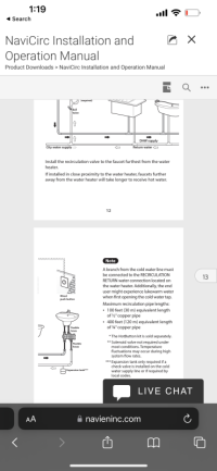

Sorry I think there’s some misunderstanding. I do know about the difference in piping and internal and external recirc. I have installed NPE-A systems where you pipe the cold into the return with a tee and a check valve on the cold side to prevent looping.
With the new A2 systems it appears this has changed but there is a lot of conflicting information on their website. I have looked through their website, documentation, and even technical drawing. If you browse through my pictures you’ll see one from the navicirc page, one from the navicirc tee documentation (which has not been updated for A2), one from the A2 install manual, and one from the A2 technical drawing off the A2 document page. Not one of these pages show the same thing.
Regarding your theory on the check valve, this wouldn’t make sense as the recirc pump is pumping into the faucets regardless of the check valve in their schematic.
I will probably follow the technical drawing that shows the check valve on the street side. I can’t think of a reason to have a check valve on the street side like they show. Im just trying to get some clarification on a few things. Don’t want to do anything that hurts the unit or voids the warranty.

The newish NPE A2 do not require special piping like the old NPE A, if only the Navcirc is used.
There are setup clicks to follow on the display.
They definitely want the added check valve on the cold as displayed in your image number one. And that also then calls for an expansion tank or those mini exp devices for tankless applications.
