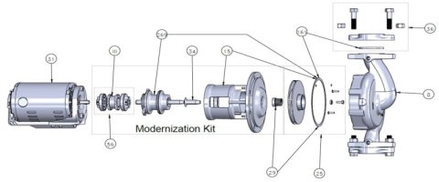

Lifespeed
409
Hmmm, maybe Navien doesn't use a self-priming pump and this is specific to Navien? Specifics matter, if you say they need bleeding I believe you. With the O-ring failures and bleeding requirement, it would appear they could have done better.
Taco pump doesn't need bleeding. No doubt it's 50X the Bill of Materials (BOM) cost of a Navien pump.
