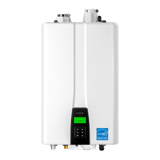

I’m thinking of replacing my 75G water heater that’s at the end of its useful life with a pair of NPE-240As. The home has a lot of bathrooms and I want to be sure we can have up to 5 at once. I will have a plumber install the units, but I’m interested in getting all the parts figured out and see if you experts can help me confirm the ideal design so they can just install. It sounds like Navien offers a set of parts for this purpose, but I have difficulty finding the parts beyond the NPEs so I can buy them cost effectively.
- I’m looking for a Ready-Link system on a rack back-to-back
- The house does not have a recirculating line, but we’d like to use the cold Circ option in these units
Can anyone point me in the right direction? Thanks!

Don't thInk there going to do what u want page 8 of this manual. Look at temperature rise. With any condensing heater need to know two things lowest incoming water temp and max gpm. Also a hot water mix calculator just touch each box to change to gpm and f
Gas line looks to be 3/4" black pipe about 1 1/8" diameter. Larger gas line has to run. Heaters could hang from a unistrut frame can purchase the parts from a box store electrical dept. Power from existing wh from a 15 amp breaker could be used for both. Then the flues and combustion air. Need to look at you tube for yearly maintenance on these heaters and yes i saw the softener.

The accessories page from Navien has the part number.
You could easily build anything out of wood as well.
The Ready-Link Manifold System is what you may want, though a plumber can duplicate readily.
you will also need the common vent collar kit,
the ready-link comm cable
Any Navien distributor will be able to order and you won't likely ANY discounting.
With so many bathrooms, you won't get very good/hardly results using any 'bridge' recirc. NavCirc or other...
You are talking some big bucks. In my opinion you will have fine results with one NPE240A2 and one 240S2 units cascading with ReadyLink. But, talk to Navien customer service to be sure given how many GPM you ideally want to run.
Lack of dedicated hot water line will not be solved, unfortunately.

Online parts availability will be difficult as navien only sell through authorized dealers. If you do find them make sure it's a authorized dealer or warranty is void. A 240A2 with a 240S2 on a back to back kit gets you 7.9 gpm at 100° rise. Depending on your ground water temp you may need a third if you want to run all baths at the same time.
