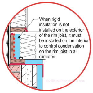

If the walls are framed wood with plank or plywood sheathing it's possible to blow the cavities full of cellulose without gutting the walls. If you're insulating it only one room at a time the room to room temperature balance is going to be changing with every upgrade.
In most houses insulating the basement walls to the current IRC code minimum (R10 of continuous insulation, in US climate zone 4, which is all of VA) it will take something like 10% off the whole-house heat load without changing the temperature balance. If it's a poured concrete or CMU (concrete block) wall this is pretty cheap & easy to do using 2" reclaimed roofing polyiso (typically about $10-15 per 4x8 sheet in pretty good condition), held in place with 1x4 furring through screwed to the foundation 16-24" o.c. with 4.5" TapCons. Tape the seams of the foam with housewrap tape, and seal the top & bottom to the foundation with can-foam to prevent convective thermal bypassing and moisture transfer. (The cut bottom edge needs to stay off the slab, since it can wick ground moisture from slabs that don't have vapor barriers under them.) To meet fire code the foam needs an ignition barrier- half inch wallboard mounted to the furring works. Air sealing and insulating the basement is well worth doing, even if you never plan to finish it into living space.
These folks have a series of short videos on how to do it, with perhaps finer detailing than you'd use for a basement you'd never finish, using glue to hang the foam (which would require hanging the gypsum on a studwall in some areas, depending on local code interpretations, which is more expensive than doing it with furring & masonry screws.)

A vented crawlspace in a place with summertime humidity as high as it is in VA is bringing in more moisture than it is purging. It's also a huge air leak at the bottom of the house, which maximizes the height of the stack-effect stack, and could easily be as much as 20-25%of your total heat load. Spending the boiler money on converting the crawlspace into an insulated & conditioned crawl space is probably the better value, even if it means keeping the beastie-boiler for another decade or more, assuming the existing boiler is fully inside the insulation & pressure boundary of your house.
Again, putting the boiler in the garage will reduce the overall system efficiency, since all of the standby losses and some of the distribution losses are then truly lost. You can only beat that if you build an insulated boiler room/closet in the garage and remove any insulation in the partition wall between the new boiler room and the fully conditioned house.
Using manifolds with home-runs to the convectors and valves for tweaking the flows can work, but it's pretty messy if you don't do the full math first.
IRC 2015 code min for crawlspace walls is R10 continuous insulation, just as with basements. It's fine to leave the existing joist insulation in place, but you definitely want to put down an EPDM (membrane roofing) or 10 mil plastic vapor barrier on the floor (does it have a rat-slab, or is it dirt?) , lapped up 8-12" onto the foundation walls and sealed in place with duct-mastic. Then lap the wall-foam over the vapor retarder, and use a horizontal 1x4 furring through-screwed to the foundation to clamp the foam & vapor barrier to the foundation. In termite zones you may be required to have a 3" inspection gap in the wall foam, which is fine- you can cut some strips of R15 rock wool batt to stuff in the inspection gap. Be sure to caulk the band joist to the foundation sill and subfloor, and insulate the band joist & foundation sill, and any ledge at the top of the foundation sill, sealing it in place with can-foam:
