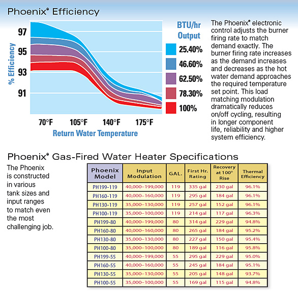

You might want to price out what a 55 gallon smallest-burner Phoenix would run you. You can run similar efficiencies as a mod-con + indirect with one of these, and it's inherently self-buffered. They're dead-simple to design around, and has plenty of burner for your needs- your design-day heat load is about min-mod on the thing, and it'll automatically run min-mod all the time except during heavy hot-water usage. I'll bet you can hit 93% without doing the math on the heating system design, just setting it to 125-130F and bumping it up 5F at a time only if it doesn't keep up in the coldest room. Without low-temp radiation, only baseboard you'd never hit 96% in your wildest dreams anyway.
Uh, sorry, I meant the Pioneer, (basically a Phoenix with a space-heating heat exchanger.)

That Pheonix unit looks nice and simple, I just can't seem to find a price anywhere for comparison to see if it falls into my budget. I think I will go with the USB Alpine80 & TT Smart 40 IDHW combination. Still not sure if it is worth the price and effort to zone out the upstairs seperately using zone valves if large ( is 6*F large?) night-time setbacks. Today it took about 4hrs. to drop 4* (35*F OD and fairly windy). As you describe, it seems better to just let the whole house drop, lets say 3* (68-> 65) for the night/day setbacks, if at all, then optimize the running temps. It's a whole new mind set vs. on/off control of oversized CI boilers. During the milder months I'll determine another running temp (flow?) that keeps me in condensing-mode longer. I'll relocate the indoor t'stat as good measure against the fireplace issue. I can't say how much I appreciate your feedback/knowledge here and on other posts except for thank you.
