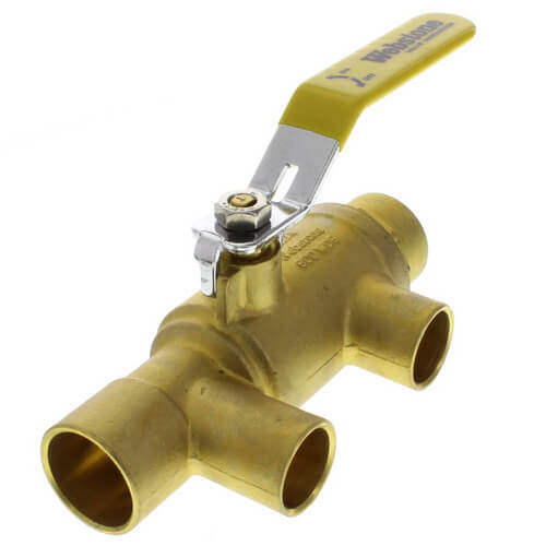

If you plan to forge ahead building your own hydraulic separator using closely spaced tees, follow these guidelines for starters:
attachment.php
Use only 1" pipe for the boiler loop, but it's fine to reduce that to 3/4" off to your PEX manifolds. You might consider using a 1" x 3/4" purging tee (keeping the ball valve open) to save plumbing time & space, since the tees are already sufficiently close to work well:
With a radiant slab there's at least some chance in hell that it won't short-cycle on you, but there isn't enough thermal mass in 1000' of PEX alone to fully prevent that.
Alternatively, a cheap scratch & dent electric water heater could be employed as the hydraulic separator, using the hot port at the top and the drain valve port at the bottom as the supply and return for the secondary (radiation) runs to your manifolds. Pull the electric heater elements and use those ports for the primary (boiler) loop. Even a 40 gallon water heater has over 300lbs of thermal mass to work with to suppress short cycling no matter how slowly the radiation is sipping heat from the tank. While there are purpose-made versions (BoilerBuddy, etc) a cheap electric water heater would be a cheaper (and still effective) alternative. It effectively becomes one of these:
Your 1/25HP system pump would be effectively the blue triangle in this diagram, whatever they shipped with the boiler would be the orange triangle.
