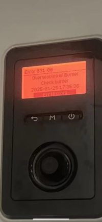

I got a problem with Space heat when I turn on space heat the Boiler will run 5-10 second and pop out Error 031-00 Overheating of burner check Burner. the pressure is 15psi when the heat start will up to 25 psi motor is running good I can hear the water flow go through every room and the temperature going up.
I have cleaned the filter and trash cap and flushing the heat exchange the problem still have. The DHW is running good not any problem.

problem solved by changed a Temperature Fuse .
1.E031-00 problem is indicate the high Temperature of burner in my case I check the burner and changed new PBC exclude those problem .the water Temperature of return and support is normal the water Flow is fine. for the problem solve we need know what sensor cause that problem.

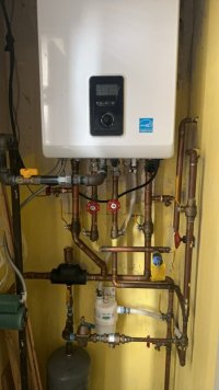

There is a expansion tank that might need the air adjusted in it. Take some pics of boiler piping and pumps. Don't stand to close want to see how the system is piped. Tools needed to check and adjust ex tank 0-50 lb tire gauge and a hand tire pump or air compressor. One or two story house. Boiler in a basement?

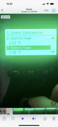

Thank you so much for your feedback. I am living a Condon the water heater is on the same Floor. I just fixed the pressure problem from changed a water pressure sensor. Now the pressure comes to normal 12Psi.but the problem still have I am no idea not parts have the problem .is it 3 way valve or Water adjustment valve?
I am plan change a Hight Limit switch this switch is beside the supply temperature sensor when the problem appear I check the return and supply temperature are 118 same as my setting.
When this error happened I hear sound like so much air in the heater even if already run air pure mode let the air out.
Any suggestion?

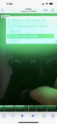

I am use Test mode for all test and found Flow Control Valve 0% Feedback Mix Valve 50% Feedback Is that abnormal?
I check the Status Information of DHW Flow show 4.5LPM is that same Flow control?

The piping doesn't look right to me and I am not even a specialist on combis.
To note: the boiler side is supposed to use closely spaced tees or the specific manifold Navien sells.
And, the DHW side (really both sides) must have descale bypass union kit.

The water pressure Solved by change a new water pressure.But the problem still have. I have changed Hight limit Switch and Exhauste Sensor.Checked the fan and Damper every things is good.Is it the problem from Heat Exchange?
Someone told me Change PCB is it works?

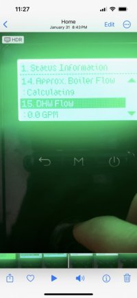

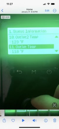

Thank you for your Feebback .Air Inlet Filter is clear The Exhaust is 122 and DHW Flow rate is Around 4.LPM when using DHW the SH Flow Rate is show Calculating。Water pressure 13.psi.
The Flow control Valve status is 68% and Mixing Valve status is 2%.
When the DHW working the Flow Control Never up to 68% Arount 65%.
All the pictures is when the Machine stop Heating
AWS Target 0.4 V Current 0.47V
Fan Target RPM 30008 RMP. Current :30007 RPM!

Your not moving any water through the boiler side. Either air bound are the pumps bad in heater. Air scoop is the chrome cap on top of air scoop loose? Needs to be.
Rockyyang
13
NewYork
Yes i took pictures when it stop working.How do i check the APS? Every things works fine after 5-10 minutes will overheating Error 031
I checked the exhaust Temperature rise very quickly when the DHW useing 1 Min it will up to 122 F but not reach 149.
Is it abnormal?

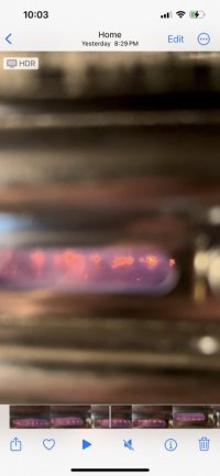

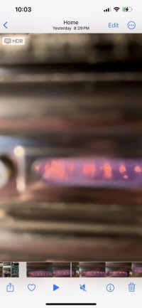

I use endoscope to check inside Burner It look clean.
Are there fuel residue accumulates?
When it burn you can see much red point inside.
