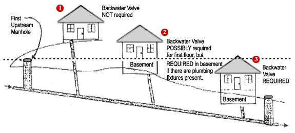

Here is a diagram that shows how to determine whether a backwater valve is needed. ONLY the fixtures on the Floor levels below that upstream manhole can pass through it.. Fixtures on Floor levels above that elevation Shall not pass through the BWV.

Thank you guys for the replies! So already existing is a backflow preventer outside the house, between me and the main sewer line. But I am fond of the idea of having a backflow preventer between the basement plumbing and the rest of the house.
