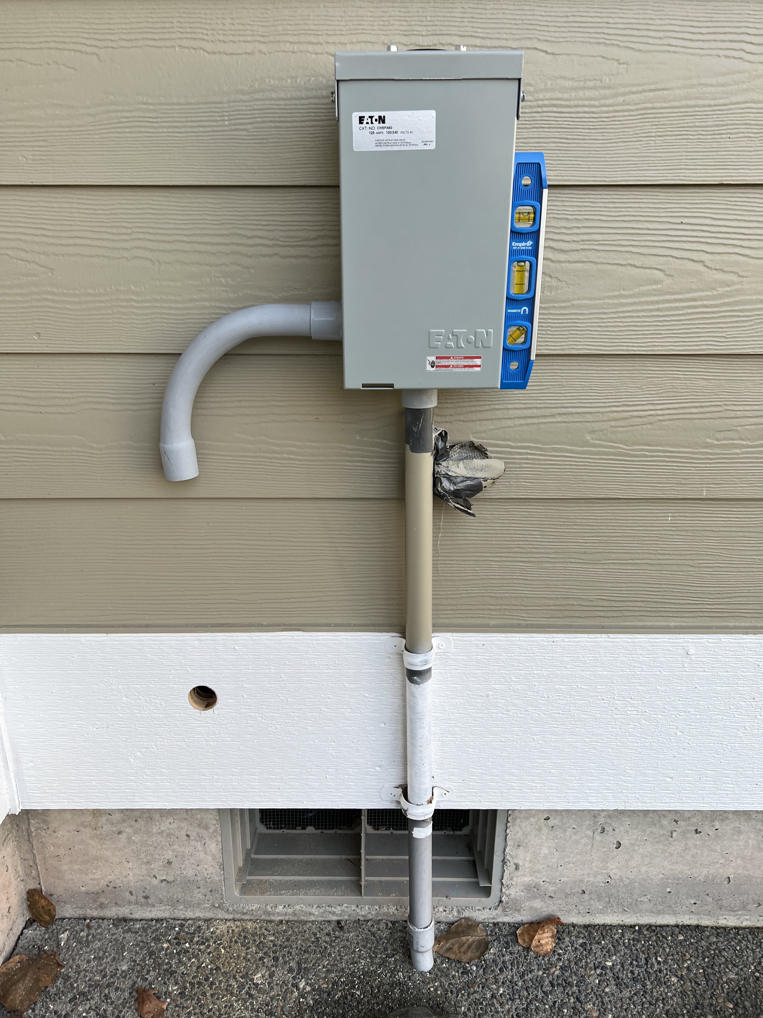

My jurisdiction uses NEC 2020. My question is:
My home was prewired with a 60 amp hot tub circuit and 6/3 NM-B was ran underneath the crawl space to where the spa GFCI panel would be installed. Is it okay to run the NM-B through an LB through the 90 and into the spa GFCI? I would then run THHN from GFCI to the hot tub.
If thats not legal, then what do you suggest I do?
Thanks
Image is here.
