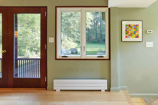

Finally - what do you think of this slimline stuff from AIM: http://www.aimradiantheating.com/store/slimline.html ?
That wrapped around an entire room (or one or two exterior walls) would look real nice. Not sure how it performs, and no data on the website...

The slimline radiant baseboards only put out 220BTU/ft per hour at 180F (about 1/3 what you get out of fin-tube) at condensing temps you're looking at about 55-60BTU/ft at condensing temperatures- you might be able to heat the basement efficiently with it, but is unlikely you have sufficient running wall length on the first floor to deliver enough heat at temps low enough to get the efficiency out of a mod-con, (if it can meet the 99% design condition at all.) If you're looking for a prettier solution than the big panel radiators, something like Runtal UF-2 (UF-3, UF-4, etc,depending on how tall you can tolerate) usually fill the bill (for a price.)
UF-2:
UF-3:
UF-4:
These radiators are also convectors, and putting furniture in front of them doesn't dramatically reduce output, but it's better to have a couple of inches of clearance to the furniture than putting it smack up against them.

One thing I have noted - if I use night time setback (down from 70F to 65F) the family room in particular with its cathederal ceilings still "feels" cold for a long time (well into afternoon), even when the air is at 70F. If I leave the temp "stuck" to 70F 24 hours a day, the room feels much more comfortable. It has 12' (center) ceiling, and is also a "step down" from the rest of the house. It has 24' of tube fin in just that room, so it does heat up quickly. I think the baseboard radiators (UF-2) would look, and work well in that room especially.
I really kind of like the look of those, and I think I could sell the wife on them.
