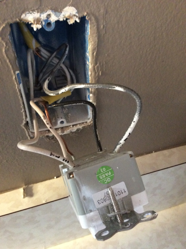

Replaced a GFCI outlet to the right of my sink. Was careful to mark all wires and photo with my iPhone. Hooked it all back up and it worked and tested fine.

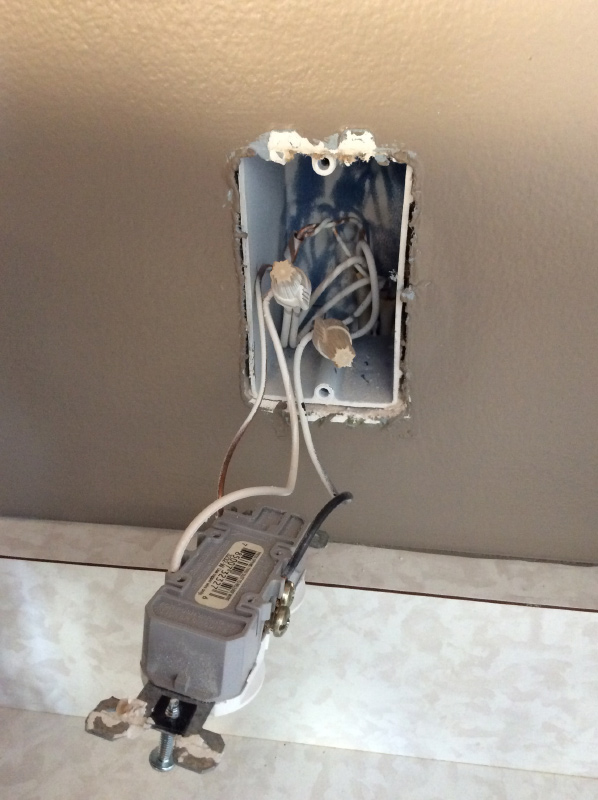

The outlet to the right of the GFCI (seen below) will not power up now. Looking at the hookup I'm having a hard time seeing if this regular outlet is connected somehow to the GFCI. All the connections look good but maybe the original hookup was wrong?

Just looking at a bunch of wires does NOT tell us anything about how they are interconnected, or if the are even interconnected. However, if ALL you did was change the GFCI, why would you have removed the second outlet?
705
28
Montreal, Canada
Your other second outlet may be in parallel, sourcing from the first one at the sink.
You did something wrong with the new GFCI.
NEVER assume that the wire positions are the same as the "old one". Consult the documentation and diagram that came with the new GFCI.
This cannot be troubleshooted over the internet with photos. Someone has to be there on-site to assess.
You may want to see a licensed professional.

The outlet to the right of the GFI should be GFI protected also, assuming it is in the bath or kitchen (and with in six feet of the sink).
Looking at the wiring in your GFI box I see a yellow cable and a white cable. Looking at the wiring in the non-GFI box I see two white cables.
That means that the cable between the two outlets is most likely the white cable and the power in cable is the yellow cable. The two white cables in the non-GFI box means that there is something else that is GFI protected, possibly another outlet.
Press the test and the reset buttons. Chances are that they do not work even though you have power out of the outlet. That would mean that you have the line and load wires reversed. If you have incoming power wired to the load side you will have power out of the GFI but no power to the sensing mechanism and cannot reset the GFI.
Since you only have two sets of wires and you have the hots on the correct side and the neutrals on the correct side, that is the only thing that could be wrong.
You may have physically wired the new GFI the same way as the old but the line and load terminals may be reversed (top to bottom)
Reverse the wires.

The proper way to test that the replacement GFCI is feeding voltage to the slave receptacle is to meter the load side output of the GFCI. It's a 1 minute test for someone with basic meter skills.
