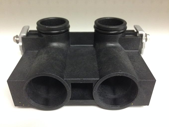

Here's another product I'm interested in getting you all's take on (Fleck right angle adapter online):
Just looking at it, this would go into the back of the valve. Then the steel or noryl bypass would go behind it, right?

https://www.qualitywaterforless.com/Fleck_19620_01_p/19620.htm
I have the equiv to that on my 5800SXT to put the tank closer to the wall.
