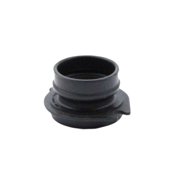

HAH.. I had to deal with just about the same thing from ISE support.. They sent me to a third party reseller to buy parts... So lets look there and see since they're so stingy with info.
InSinkErator 75499​
This flex coupler is for use with the Evolution Series garbage disposers. This mounts at the discharge of the disposer and is held to the disposer by a single screw part # 74129. The flex coupler is then connected to the tailpipe with the spring clamp part # 74701. The 90 degree tailpipe is sold in a kit, which is part # 2610WJ or the 12″ straight tailpipe is available as part # 74012.

All the parts you mention were included with the garbage disposer I bought. The solid curved discharge tube will not align with the vertical drain pipe that is attached to the waste trap. I would therefore like to use the FDT-00 flexible discharge tube. BUT, the FDT-00 packaging and the ISE web site say that this flexible discharge is not compatible with the Evolution disposers. The FDT-00 does fit into the Tailpipe Mount (75499) so I'm wondering why ISE is saying not to use it. I do have an old metal mouting plate which is the same size as the one the comes on the 75499. The plate fits on the FDT-00 so I'm wondering if I can use it to attach the FDT-00 instead of using 75499.

The non-flexible discharge tube and the flexible discharge both have a raised lip. Both fit into the anti-vibration connection. Just wondering why manufacturer says using the flexible discharge tube is a no-no. The waste lines and trap are glued in place and can't be moved......would have to redo to work with the Insinkerator non-flexible discharge tube. The waste line and trap positioning were originally installed to work with a GE disposal which had different dimensions i.e distance from centerline of disposal to centerline of discharge tube/waste pipe.
Also, the flexible discharge tube (FDT-00) comes with a gasket that fits over the raised lip and I have a flange that is the same size as the flange that is on the anti-vibration gasket. It fits on the disposal. Maybe use it? Will things be ok if the anti-vibration connection isn't used?
