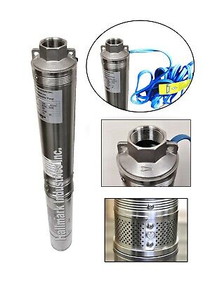

Hi all.
My jet pump is in my finished basement closet and is LOUD..
Looking to change to a submersible pump in the Spring (also hoping to up my flow rate a bit for my maze of filters..)
Local company wants $160 just to come look and give a quote, so before I shell out that money to find out that I can't afford it or something, could anyone give me a ballpark on this job? I have a dug well ~15ft and it is ~100ft from the house.

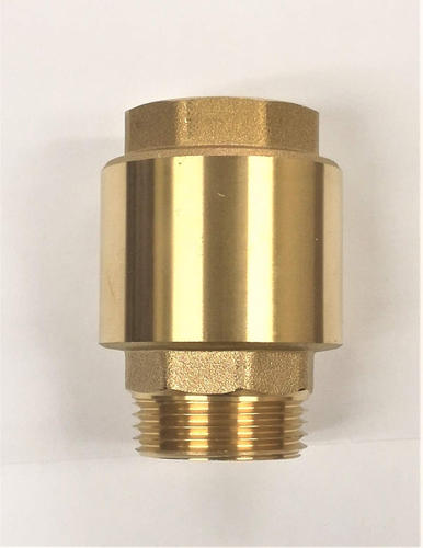

As long as the casing is at least 4" diameter and half the 15' depth is full of water, a submersible is an easy and quite fix. You can get one of those Hallmark 1HP, 33 GPM, 230V pumps for not much more than that 160 bucks. But please purchase from Ebay or anyone except Amazon. Adding a good check valve on the pump and a PK1A kit to control everything, you will have strong constant pressure with no noise.

Pump $170.00

Check Valve $40.00
