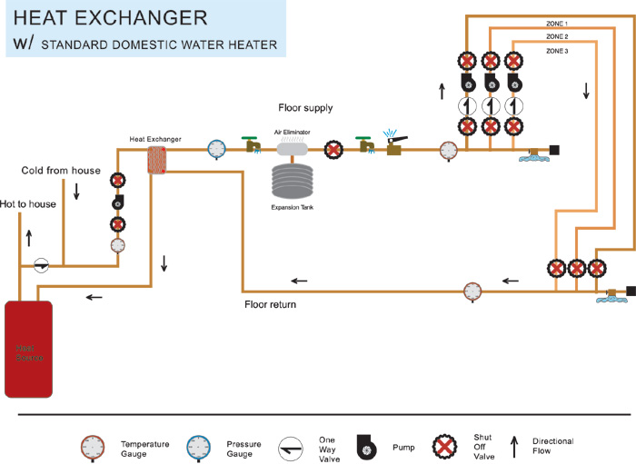

Speaking on the boiler/water heater subject, I guess I dont fully understand how ONLY a water heater would work for heating the home. Also, we will not be using standard baseboard heaters. We will be installing hydronic wall radiators such as the Myson T6
http://www.mysoncomfort.com/products/t6.htm

To properly size the flat panel you'll need to run a room-by-room heat load calculation. Hire an engineer or RESNET rater for this, and NOT an HVAC installer. The 99% outside design temp in your area is about -2F, so my WAG estimate of your whole house heat load is still in the right range.
You'll notice in the Myson brochure that the radiator output is specified at a few different AWT (Average Water Temperature) points. With a hot water heater you'll be able to get better than 140F AWT, but depending on the model maybe not any higher than 160F. If you size the radiation in each room using the 140F AWT spec for the radiators it'll end up being more radiator, but it'll also be more comfortable. The ratio of heat load to radiator output needs to be roughly the same in each room on the zone to have reasonably close room-to-room temperatures.
There is not sufficient water mass in the panel radiators to suppress short cycling on a boiler without ridiculous oversizing factors on the radiators. If you use a boiler you would still need a buffer tank.
Designing a heating system around a hot water heater involves two pumps and a heat exchanger near the boiler. The heat exchanger isolates the potable water from the heating system water. When there is a call for heat a pump on the potable side (bronze or stainless, to keep it from corroding quickly) pulls hot water out of the tank into the heat exchanger and from the heat exchanger back into the tank. A the same time the circulation pump for the heating system starts up, pulling the heated system water out of the heat exchanger, sending it to/from the radiators. This does not require hard math from any competent hydronic heating designer, but not every boiler installer is comfortable designing these types of systems:
An oil fired HW heater won't last 25 years the way a well-implemented cast iron boiler would, but they're quite a bit cheaper, and you'll make up for it in higher efficiency due to the fewer (but longer) burn cycles.
For more money you can do pretty much the same thing with a cast iron boiler and a buffering external tank. It'll last longer, but it's not clear that it would actually "pay". There are buffer tanks with potable coils suspended in the heating system water sometimes referred to as a "reverse indirect" that would be able to supply both the domestic hot water and the buffering thermal mass for the heating system:
Building these "Rube Goldberd Contraptions" is only necessary due to the fact that the smallest burners are nearly 2x the output needed for heating the house, and running at a low average duty cycle. It's cheaper/easier to suppress the cycling with thermal mass (a tank of water), than installing insane amounts of radiator on each zone to balance with the boiler's output heat. Boilers don't have enough internal thermal mass to keep the number of burn cycles down when the (also low mass) radiation on any given zone is significantly undersized for the boiler output.
For the record, when I micro-zoned my own home I went the "reverse indirect" route, using a gas-fired low-mass tankless hot water heater as the "boiler" rather than installing enough radiation in each zone to balance with the minimum output of a modulating boiler. Gas fired modulating condensing boilers have improved their modulation ranges at the low end to the point where I could have gone that route if starting over today and been ~5-10% more energy efficient, but there's no point in getting rid of the reverse indirect at this point. When the tankless croaks I'll replace it with a small condensing boiler, but won't re-plumb the system.

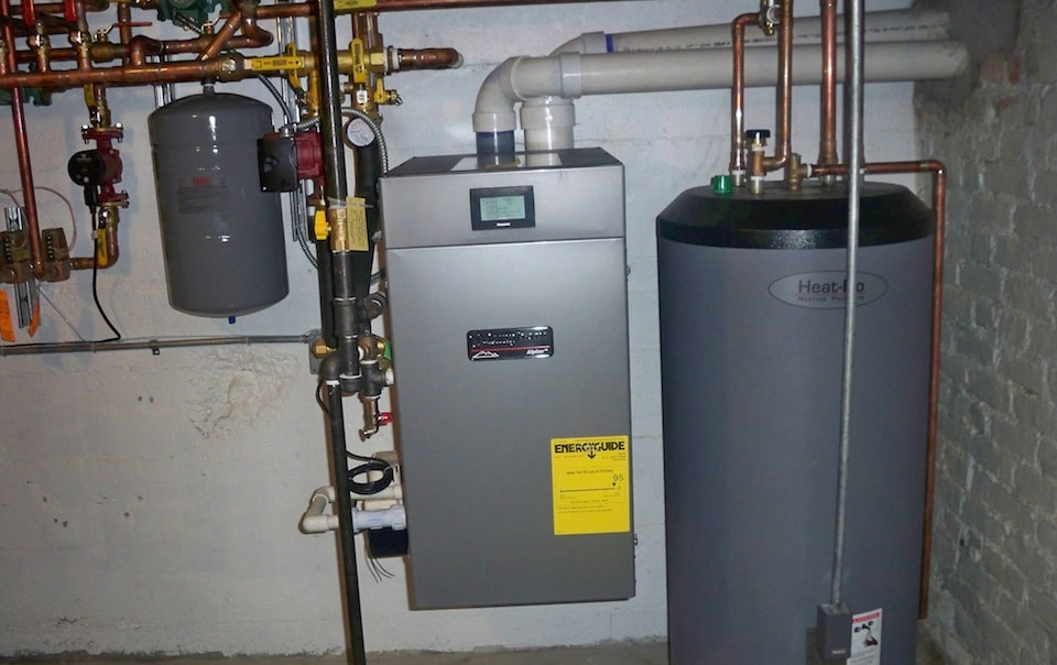

i dont want to take op post attention, but my house is an old roughly 1000 sq. winter gets really bad. Someone mentioned electrical boiler can work. This hvac guy from home depot recommended navien with 80-100 BTU with my tank.
is it overkill?
Dana
In the trades
7,889
512
01609
Yes, an 80-100,000 BTU/hr boiler would be complete overkill for a 1000' house, unless it has single pane glass, no wall or attic insulation and is located in Fairbanks, AK.
To assess what really makes sense it helps to know your location (got a ZIP code?), since "... winter gets really bad..." gives no clues as to what the 99th percentile temperature bin would be, (also called the 99% outside design temperature) which is one critical piece of information to start with.
If you have been in the place for a heating season it's also possible to derive what the heat load is at any arbitrary outdoor temperature based on the amount of fuel it took to heat the place, using the existing heating equipment as a measuring instrument.
With the heat load numbers accurately estimated you can size the solution correctly, then there is the matter of what the local energy pricing is. In most locations natural gas would be substantially cheaper to run than an electric boiler, but in some locations an air source heat pump would work out favorably. In some places #2 oil would be 2-3x as expensive as electric boilers, in others electric boilers would be substantially cheaper than oil. In most locations propane would be more expensive than #2 oil. Since all utility markets are local, it's important to look up the local pricing (and pricing trends) when trying to come to a decision.
What is meant by "...with my tank..."- something like this, mayhaps? :)
or maybe one of these?
...or was it one of these?
