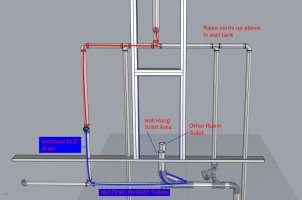

Update and Feedback/Suggestions Apperciated
I took out all of the drywall and cut away the subfloor to expose the rest of the plumbing. It looks like I'll need to remove all of the drain system in this bathroom. The sink drain goes into a sanitary tee on it's back. The back to back toliets go into a double sanitary tee that sits on top of another sanitary tee on its back with an adapter at one side to receive the sink drain.
On the bright side, that means I might be able to put in a wall hanging toilet now.
I have a few questions and also looking for suggestions on what to do since it will be a blank slate mostly.
1. If I go with a wall mounted toilet in this room, would you try to have both toilets enter the main drain at the same point like before, or have the other toilet enter the main drain a little down the line? How would you work around that vent pipe going to into the attic?
2. Related to the vent pipe.
3. For the shower. I can't find any sanitary tee with a side inlet in all 2" that isn't special order. I don't mind having each shower drain connect into the main drain with separate connections. I only have 5" of horizontal space from the center of the linear drain to the center of the main drain. If the P-Trap is straight, it ends directly above the main drain. What would you suggest I do in that area?
Thanks again in advance for any feedback and suggestions.

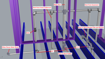

Attached is the existing layout for reference and a close up of the back to back toilet.

A couple comments: wet venting could possibly simplify the vent side of your double bathroom DWV redo, but IL has its own plumbing code, which I'm not familiar with. So I'm going to stick with the idea of dry venting everything like you previously had. If you're interested in reading about the wet venting provisions, they are readable here (might require a free account):
Also, I assume if you are going to redo both bathrooms, you don't want to change any of the drains under the other bathroom, but rather work with them starting with where they current enter into the space below the wall you opened up?
1) Definitely easier to connect the WCs separately to the horizontal drain. The double san-tee over san-tee on its back in your photos has its two hubs touching. The proper replacement for that configuration would be a double wye/combo over a combo, and the height difference between between the two incoming horizontal upper drains and the outgoing horizontal lower drain would be much greater with that configuration than with what you have. The only downside to separating the connections is that you'll have separate dry vents rising up to your dry vent header. The one not in line with your "main vent" could be 2".
2) If this is a question, I think you never actually posted it. : - )
3) If you connect the drains separately to the horizontal drain, then again you'll have two separate dry vents rising up to your vent header, but they could each be 1-1/2". Anyway, as per your rendering in the OP, you have a degree of freedom at the trap joint between the u-bend and the outlet elbow. It matters not at all what direction that u-bend is pointing. So if you want more space, you could point the u-bend almost directly away from the lower horizontal drain and then point the outlet elbow back towards the lower horizontal drain [Obviously the u-bend can't be directly away from the lower horizontal drain with the outlet directly back, as then the trap arm would intersect the linear drain tailpiece, so you do need some clearance.] Then just hit a 2x2x1-1/2" san-tee (which is available street if necessary) and drop into an upright 3x3x2 combo to join the lower horizontal drain.
If that would be too high (the difference in elevation between the combo outlet and the san-tee inlet), then as long as your trap arm is coming towards the horizontal drain perpendicularly in plan (when seen from above; the two lines are actually skew, so they don't actually intersect), you have the option to rotate the san-tee 45 degrees around the horizontal inlet/trap arm, and then the outlet can go straight into an upright wye. The top entry gets a street 45 so the vent can rise straight up from there.
Cheers, Wayne

For that missing 2nd question - It was to ask about moving the toilet vent from that area to make room for the wall hung toliet. This is what I'm thinking of doing.
Combo Y for the new Wall Hung Toilet
A long 90 going into a Y on the horizontal "main drain".
Combo Y for a 2" vent
The new vent location ties into the existing vents and travels back to the original vent location but a bit higher up on the wall to make room for the wall hung toliet tank assembly.
What do you think about this arrangement?

Two comments on the latest rendering:
- The configuration of your wye vent takeoff shown is backwards. The idea is that if water backs up into the vent due to a clog, when the clog is released, the water is to be directed to drain normally. You have it directed uphill in your wye orientation.
- If you want to individually dry vent everything, then each fixture needs to have a dry vent taken off from the fixture drain before that drain joins any other drains.
Now individually dry venting everything is onerous when you have 5 fixtures (the other lav is the 6th, but you are not showing its venting in your rendering; I'm assuming it is properly individually dry vented). That would mean that if you take a plane say 30" above the floor (above the lav traps but below their flood rims), you'd have 5 different vertical vent pipes from the 5 fixtures, unless some of the fixtures are common vented via a double fitting, as in your previous arrangement (where that happens twice, so you only 3 vertical vent pipes from the 5 fixtures).
So you could look at wet venting, but you'll need to check your IL code; I'm only familiar with what the UPC and IPC allow. The UPC would let you use one dry-vented lav drain to wet vent one shower and one WC (but the WC has to be last on the wet vent, except for WA state which amended that rule); you could have two separate branch drains, one for each bathroom. One problem with using a drain running below the joists to wet vent a shower is that the the trap arm (from trap outlet to the horizontal wye where the fixture drain joins the horizontal drain providing the wet venting) is limited in fall to one trap diameter. So basically the shower trap arm would also need to be below the joists, and the trap would stick down even farther.
The IPC allows horizontal wet venting for up to two bathroom groups at once, and doesn't require the WC to be last. So you could use the dry-vented lav coming in on the left to wet vent both WCs (e.g. via your last rendering with the 2" vent is deleted), and both showers if that doesn't put the shower traps too low for you.
So check what the IL code allows if you want to look at wet venting. I can say with confidence that you could use the lav coming in from the left to wet vent one of the WCs (possibly in the configuration shown in your last rendering, although the rules may prohibit the WC from joining the drain providing the wet vent from above, in which case you'd have the WC being wet vented join the lav via a horizontal wye), and then you could use a dry vent takeoff on the other WC's fixture drain to dry vent it. But the IL code might require that the lav drain and its vent be 2" (the UPC does; the IPC would allow 1-1/2"); I don't recall if you've said what size those are for the lav coming in on the left.
As for dry venting both WCs, with a wall hung WC you are looking at two separate vent risers going up to your vent header. If you have a 3" horizontal branch below the joists in line with the wall, you can vent the wall hung WC with a wye (vertical barrel) between the elbow in the wall behind the WC, and a combo for the drain to join that horizontal branch. The branch of the wye would point upwards to a 45 (possibly street) to turn the vent straight up.
Cheers, Wayne

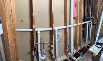

I went ahead and took a panoramic picture to show the entire existing plumbing for reference.
From left to right for the current venting.
1-1/2 vent from the other bathroom Lavs
That goes into a 2" vent pipe from this bathrooms Lav.
There is a 1-1/2" vent that I am assuming goes from the bathroom Lav on the lower level.
2" into a 3" vent for the existing back to back WCs.
The 3" vent goes up to the roof
On the other side is the existing back to back shower/tub and shower with a 2" vent.
That last vent is a 2" vent that I'm assuming is coming from the toilet in the bathroom on the lower level. The metal vent right by it is the lower level bathroom exhaust.
It looks like I'm able to wet vent my 2 bathrooms based on this from the Illinois Code:
  1. Bathroom groups installed back-to-back consisting of two water closets, two lavatories, and two bathtubs, showers or floor drains may be installed without individual vents, provided that:
    1. The water closets are wasted to a proper vertical drainage fitting;
    2. The bathtubs, showers or floor drains connect to the stack at the same level as the water closets;
    3. The lavatories connect to the stack at the same level; and
    4. The vent is a minimum of 2 inches in diameter. (See Appendix K.Illustration T.)
Thank you again for your help,
Zach
The illustrations for the IL code are quite helpful:
What the text you quoted means is illustrated in illustration T. I don't think you'd easily be able to do that for a number of reasons.
Also, the lower part of illustration S shows that any wet vent has to be 2". If your lav drain coming in on the left from the other bathroom is 1-1/2", then it is not currently useful for wet venting. You'd have to upsize the lav drain to 2" starting at the san-tee behind the lav.
Cheers, Wayne

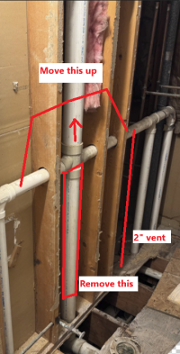

That doesn't quite work as you now have a horizontal vent below the floor, upstream of the wall hung WC. With no fixtures washing that horizontal vent (it's a dry vent), that's not allowed below the fixture flood rim. With the other bathroom lav washing that horizontal vent (it's a wet vent), that is allowed below the floor.
Instead, keep the 1.5" other lav drain as is going into a 3" combo under the 3" main vent. When the 2" lav drain from this bathroom's lav comes through the floor, hit a 45 to turn to downward and away from the camera, then a LT90 to turn horizontal under the joists and parallel to the 3" horizontal line, connecting to the other bathroom's WC fixture drain same as you show in your last diagram.

Hello again Wayne,
I was able to dry fit the parts together and everything looks like it will work in what I have in the black rectangle in the illustration.
During the dry fitting I discovered my Main vent location will interfere with a recessed medicine cabinet. I can get around that by using a 90 degree elbow with a heal inlet that the existing dry venting can go into. I labeled that (A) in the image. That moves the vent out of the way of the medicine cabinet.
From there, I need to go vertical almost right away to move the main vent out of the way of the framing for the wall hung toilet. In that area is also a vent from the vanity on the lower level. It would be easiest to use a 90 degree with inlet again here and have the lower dry vent go into that inlet. This is labeled as (B) in the image. Since this is dry venting, it seems okay for 90 degree elbow to be used that way.
From there I'm now vertical on the main vent, but off from the existing main vent by a foot or so. I was thinking of using another 90 degree elbow with inlet to tie in the dry vents from the new shower and lower level vent coming in from the right in the illustration. This is (C) in the image.
Does all of this seem logically and workable for my scenario? Is there a better suggestion to tie in the dry vents into the main based on the recessed medicine cabinet and wall hung toilet framing?

If A and B are at least 6" above the lav flood rim, then that's fine. If not, you are supposed to avoid the horizontal vent segment between A and B; you could do something similar with wyes. Or maybe jog the vent from the lower level and put the 3" vent where it was, so that you don't need to do that little A/B jog at all.
