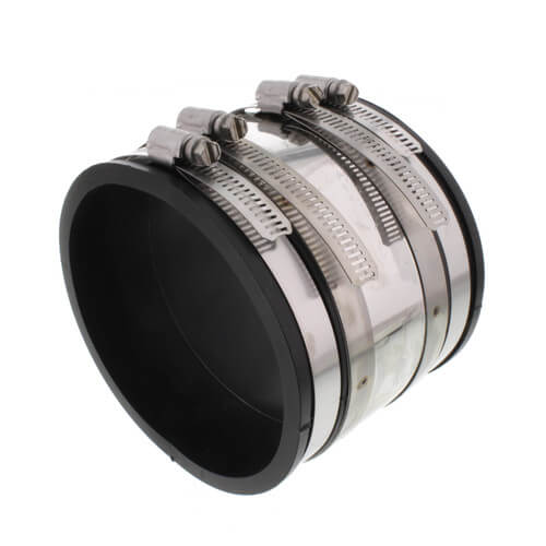

So if i put in a riser clamp i can attach the 6 ft pvc pipe. Is the cast iron pipe clamped to wall up to roof so that can help with holding the vertical load with the riser clamp also.

Besure to use Furnco Couplings with the SS ban.
shopping
Raiser Clamp
