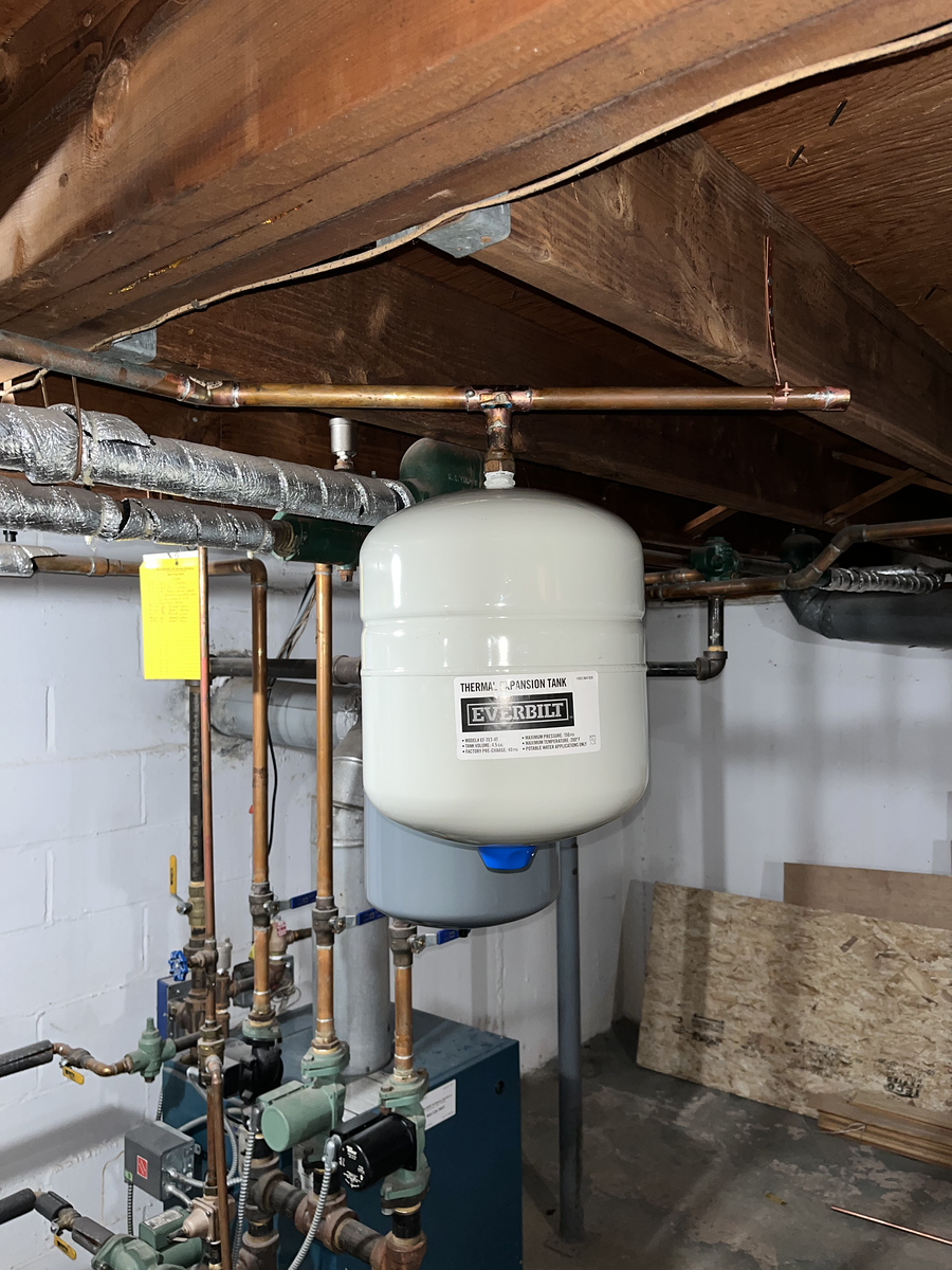

I went ahead and installed the Watts 50080 on my dedicated return loop (pulling from the end of the loop, pushing into the cold return of the tank) and added a swing check valve on the cold water line to prevent backflow, and a 4.5 gallon expansion tank on the water heater side of the check valve to allow for expansion since my understanding is the check valve makes it a closed system.
Question: I plumbed the expansion tank off one leg of a T and used about 10" of 3/4" copper pipe between the T and the tank, to hang it in a convenient location. Is what I did okay? My concern was whether an expansion tank has to be connected perpendicular to flow, or if it doesn't matter if it's on the end of a run. I was worried whether air could be trapped in front of the expansion tank since it won't have flow past it (does this matter?)

no you dont need 2 tanks the one tank would have worked check valve dosent matter as pressure would come around other side and get absorbed by the tank

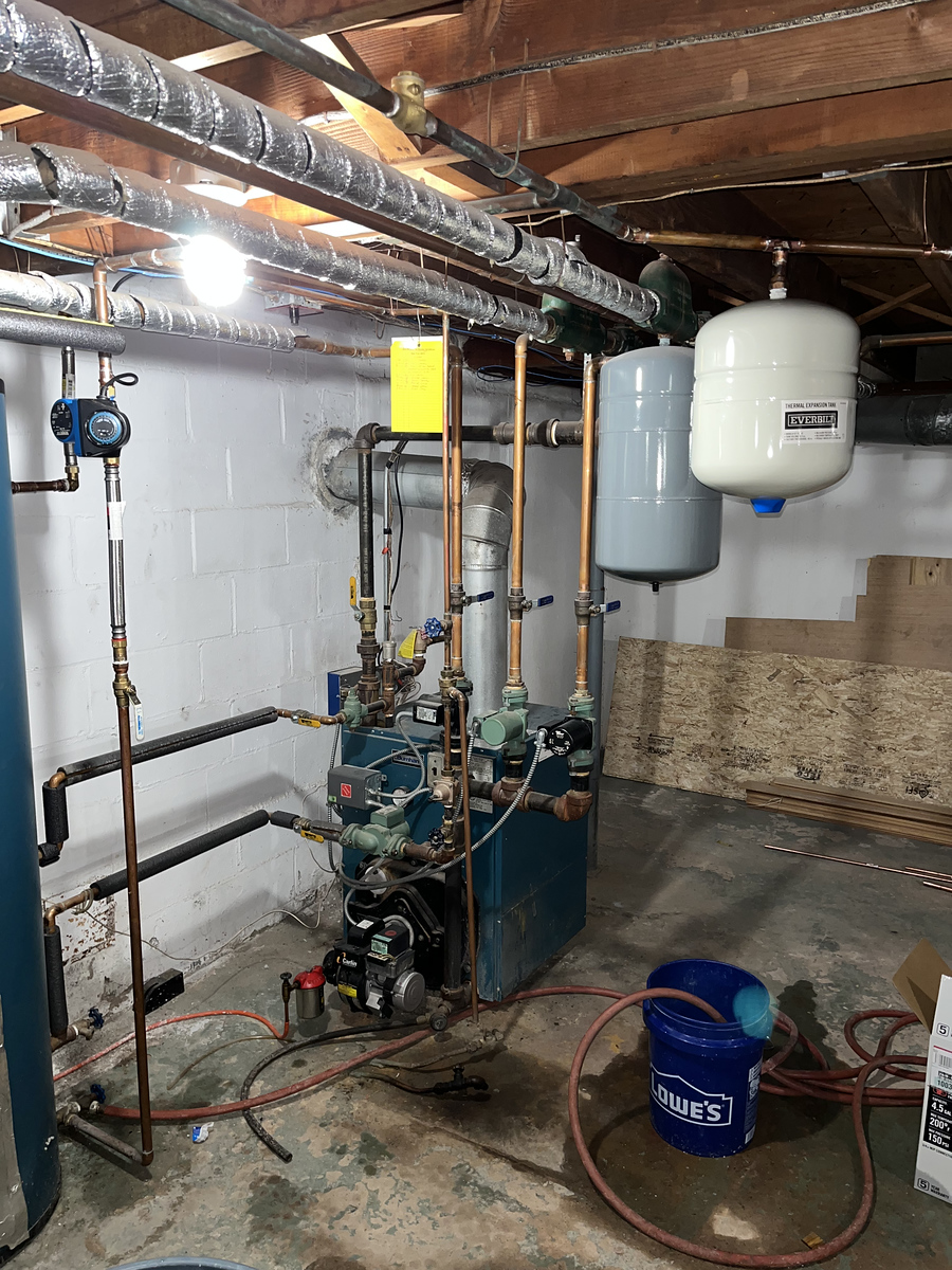

The other expansion tank in my photo is for my 3 zone oil fired, heating system, it is attached to one of the air scoops on a heating zone.
Ok so only one tank but the check valve on the circ line doesnot create a closed system . I thought you said you added a tank due to the check valve

You have added a "dead leg". Plumbing engineering 101 rules are that any dead leg over 3" is to be avoided on potable water systems due to stagnation.
We typically fully support expansion tanks with site made or mfd strap kit (usually at a wall or ceiling and route piping run to be in the flow zone.
When we do it, we add a shutoff and a hose bibb to allow for easy change out.
Follow exp tank instructions for setting pressure.

Thanks for the reply, that's what I was worried about (without fully understanding why). Now that I have a name for what I did I did some reading.
It sounds like I almost installed the check valve & expansion tank correctly for the recirculating pump setup I added. The problem being the dead leg length. The 'dead leg' portion of my plumbing was done because it seemed like a nice way to hang the tank and for no other reason. I ordered a tank strap kit and will delete the dead leg and support the tank w/ the bracket per your suggestion.
I just bought 3/4" ball valves w/ drain ports in bulk so when I replumb this I can add one in front of the tank.
