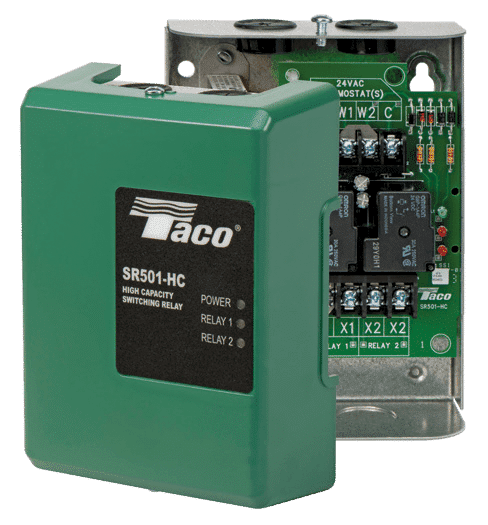

Are there separate circulators, or one circulator with multiple zone valves? Are you getting voltage to the zone valve that was changed out?
It's always difficult to suspect where the problem is without actually seeing the whole picture. Usually you'll have a TACO unit or another brand to control multiple circulators or zone valves. The click you hear might not be the actual furnace but a relay elsewhere. Below is for two zone, however, the color will be the same for larger units. You might have a Honeywell unit. Either way I would first look into these type of units. I do not think it is your furnace for the little information you were able to give.
A second thought is the in-floor heating system maybe separate from the other heating zones that are working. That is each has their own control to the furnace. If the click is from inside the furnace, it could be a relay was added to control the furnace for the floor heating zones.
